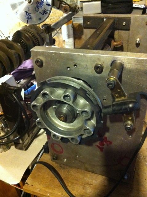

After skimming through the documentation, I rewired my bench rig to suit my GTS1000 (4-0 VR crank trigger + 1 cam lobe VR trigger), and under cranking I got no RPMs detected, so no simulated "injection pulses" from my bank of 12V LEDs.
As I had issues with cam lobe to sensor clearance affecting I reduced this from 2mm previously to sub 0.20mm, to boost the voltage generated.
At this point the VR crank input is wired as per normal, and VR2- from the cam was sharing a common ground with VR1-, like the previous MicroSquirt documentation, but under cranking, there was no RPMs detected.
Next, I disconnected the VR2- common ground and left the VR2- input floating. I cranked the rig using the cordless drill and again no RPMs were detected, but as the crank was slowing down under its inertia, I picked up the VR2- floating contact with my finger and the injectors flashed. I glanced across to the TunerStudio tacho, and saw a brief RPM figure before the crank slowed to a stop. 8)
This suggests I needed an earth/ground, so I used the SENSOR GROUND (white/black loom wire), and I got rocky steady RPMs from 52-1436 on the TunerStudio tacho. I don't like the idea of the AC spike going into this pin 20 ground, especially as there can be around 100V p-p at high RPMs, so I hooked the VR2- to the GROUND plane, aka pins 21-23 and cranked the rig again. The LEDs flashed and RPMs were rocky steady, and went from 51-1423 revs.
I increased the air gap at the cam lobe to VRsensor to 2mm and there was no change in RPMs detected behaviour, so I increased the gap to 3mm and again RPMs were successfully detected from 51 revs upwards.
This is a major step forward in RPM detection with dual triggers, and especially for my set up, there are huge gains in the VR2 cam lobe detection over much bigger distances of the order of at least 30 fold (at 4mm the minimum RPM detected was around 80 revs).
I need to do more tests on the effects of putting this VR2- input into the ground plane, and check the interference levels.
Anyway a very positive few hours, and interesting feedback on the cam sensing capabilities using a VR sensor.
PS I am not using Auto Trigger at the moment, because my crank cam drive on my rig is by a rubber tyre (O ring), so it's position isn't fixed like a cam chain arrangement.

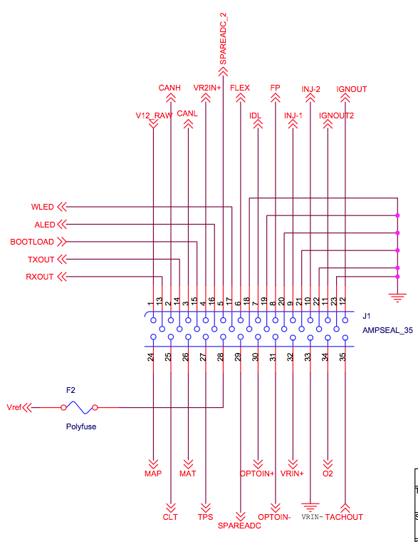

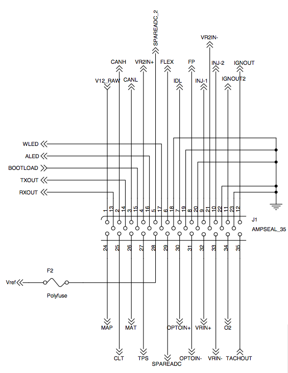

24c wrote:This suggests I needed an earth/ground, so I used the SENSOR GROUND (white/black loom wire), and I got rocky steady RPMs from 52-1436 on the TunerStudio tacho.
Just thought I'd stick my hand up here, I failed to notice that although the v3 MicroSquirt Ampseal is pin compatible with the earlier v1 & v2 cased MicroSquirts, pin 20 (white/black) is _now_ a VR2- input. :oops:
(61.6 KiB) Not downloaded yet
(64.91 KiB) Not downloaded yet
Please ignore my wiring comments earlier, and no wonder everything worked OK. :lol:

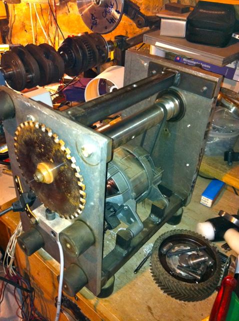

I had made a new trigger wheel to fit a crankcase pulley on one of my old car engines the other day and I have been using the beta unit as a back to back test against v2 cased MicroSquirts running MSExtra and B&G code, and the v3 running 3.760 has been the best performing so far. I was able to identify a trigger wheel design error on my part, I made a 3mm wide trigger wheel for a 2mm Renault VR sensor and the run out variances played havoc with the sensing. I switched to a wider (6mm) old 36-1 wheel that I fitted to the "washing machine motor rig" and everything is faultless from 50-11780 rpm. Well impressed . 8)
Initially OK, sync errors at 3000 rpm upwards- wheel too thin
