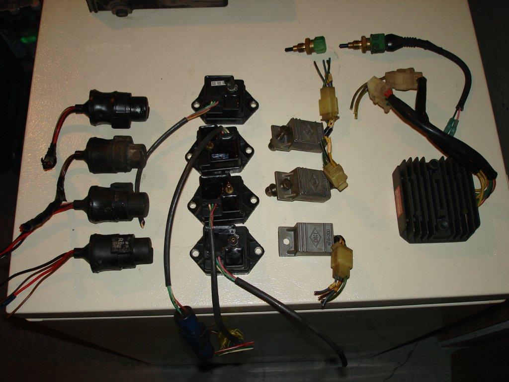

I know that you have indicated you wish to keep this project 100% stock in nature (which myself I'd just bite the bullet and go with numerous alternate off the shelf and more reliable common items as they become a topic) however, I do have 4 stock injectors (amongst numerous other stuff) from a couple of donor CTX650's that I drew various items from, that could be available if you wished.
