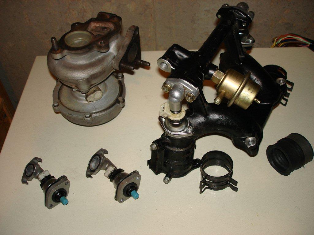

Below I'll attach a few photos - all items came from a couple of low hour CTX650's that I had entertained utilizing for my boxer project prior to learning about MS. There are 2 of everything (or four as might be the case, etc.)
Perhaps you might PM me to discuss further, I suspect that would be more in keeping with forum rules and such.
