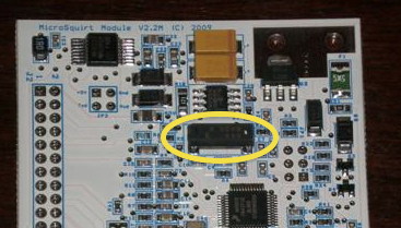

The tallest component, circled in yellow, on my module board is approximately 3.5mm above the circuit board, but I don't have any pin out connectors attached to the 50 pin or the 10 pin J1 connector.

Perfect - thank you!
