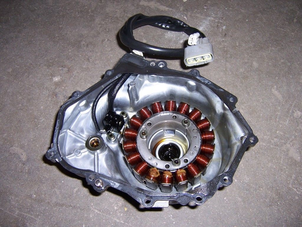

the only pickup for the ignition is this. (see picture)
(180.93 KiB) Not downloaded yet
Re: 3 cyl. yamaha engine, fuel only or fuel and ingnition?
Yes, that's the pickup coil. Can you post a pic of the rotor and the teeth?

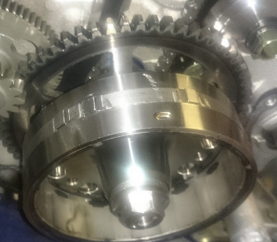

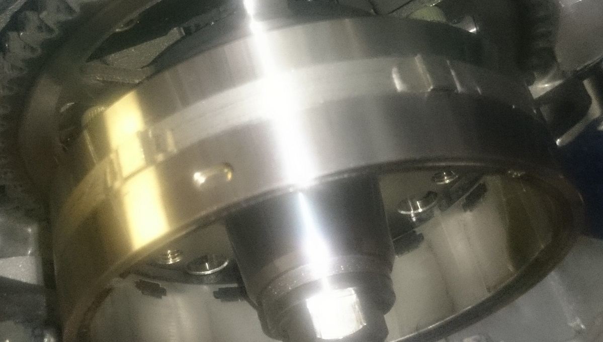

here are som pics...

EWflyer
Posts: 98
Joined: Thu Feb 05, 2009 6:54 pm
Post by EWflyer »
Looks like another one of those goofy Nippon Denso corp trigger wheels. Those guys are certainly marching to the beat of their own drum.
Please confirm that's a 6+1 wheel. If so, you'll need to remove the odd tooth and one of the regularly-spaced teeth, making it a 6-1. The uS should work nicely with that.

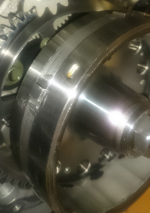

white marks where the teeth are.
so if i remove the two teeth thats close to eatch other.
it would work?
ill end up with the total of five?
(239 KiB) Not downloaded yet
That should do it. Some inline-4s get a little finicky about where the missing tooth is due to compression slow-down when cranking, but those are generally 36-1 or 12-3 wheels on 180 degree cranks (1-4 and 2-3 come up every 180 deg). With 3 cyls at 120 degrees and a 6-tooth wheel, I don't think you'll have the same problems.
