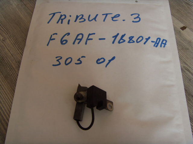

Not allowed to post ebay links, but it really is a good source fir pics. I found these after a quick search - the first is an EDIS-6 coil pack, with the cap in the top right, while the second is the cap itself.
(32.65 KiB) Not downloaded yet
EDIS Cap.JPG (29.83 KiB) Viewed 2542 times
Re: EDIS
Posted: Fri May 17, 2013 8:08 am
by BaldiGit
Ah-ha, sort of like I had imagined. My dilemma now is ..... Should I source a Ford F6AF-18801-AA or would an electrolytic 25uf capacitor do?
I might have dived off the deep end accusing the person who sold me the engine of cutting up the loom...... What I actually have is a complete Engine loom and an EDIS unit chucked in with the remains of a loom attached. What I couldn't work out is how I had 2 EDIS plugs....... Doh. :roll:
Thanks for the pictures, you've been most helpful.
