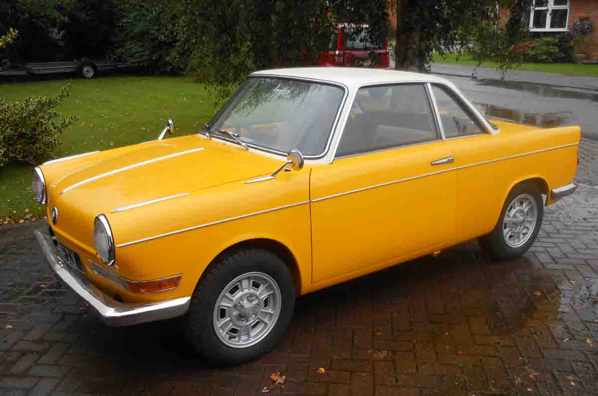

I am using the original BMW 700 engine which is a derivative of the R69 motorbike engine, but with a dynastart and fan cooling. I suppose that one way of looking at it is as a two 300cc Isetta engines with a common crank, but 350cc barrels on each! Crank is the built up roller bearing type with large ball races at the front and rear. It drives through a custom BMW transaxle used only on the BMW 600 and 700, with the engine and drive in the rear of the car.
The Engine is very much a 'sport' spec one so should produce significantly more than the 'straight from the production line ones. There weren't very many coupes made, and the early ones appear to have been light weights and were extensively used for club racing in the late 50s and early 60s in Germany. Mine is one of the original UK RHD imports - there are reconned to have been about 120 imported in total to the UK - they just would not sell because they were so expensive. There were also about 280 RHD short wheelbase and long wheelbase saloons imported.
Will see if I can dig out a photo

R100RT

As you can tell from my signature, I'm no stranger to the boxers as well. My engine is a slightly larger 980cc twin, and has much less valve overlap. I am going to chart valve train travel per crank rotation to confirm if my intakes open @ 16BTDC, which may be providing me a tad of backfire up the intake when on boost, due to wasted spark. If confirmed (right now I am just assuming cam spec as per build data) I will be adding a cam sensor and loosing wasted spark for sequential ingnition.
I've continued using Map for throttle control, as @ idle I pull a pretty calm 65ish. That of course is conditioned via the popular "orificed buffer" chamber that is fed from a tee'd feed from both inlets.
Do you have any photos of your engine residing under the bonnet?

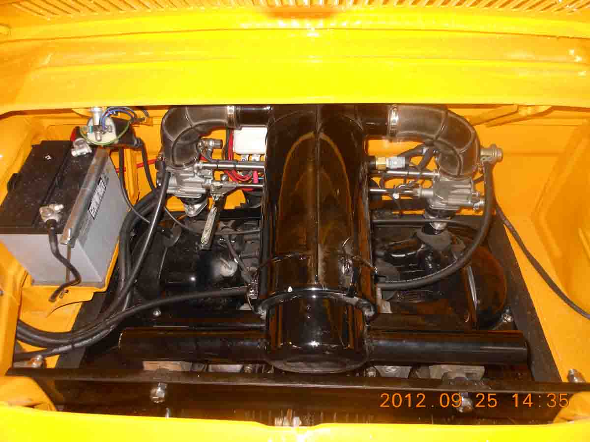

The engine bay, the Microsquirt is out of shot on the right hidden inside a rear brace, ans there is a home made aluminium swirl pot on the opposite side that holsa about 0.75 litre of fuel and the Honda VFR high pressure pump. This is filled using a little Facet pump at the front by the tank, controlled by a 2-strok oil tank level switch and a relay!
(63.08 KiB) Not downloaded yet

The engine spec I am using is above, runs very nicely, but there is no MAP reference, I haven't tried a vacuum pot - I have used pure Alph N before and it works very well it also allows you to mimic good Map variation at small throttle openings. Where am I up to? well it needs a lot of hot and cold cranking fuel because of the high overlap and the comparatively large throttle opening that is therefore needed at tickover. Engine pulls well even from low revs, it will pull without snatch (or poping back) from about 1500 rpm in top, Engine starts to pull quite strongly from about 2000, is cooking on gas at 2500, and then starts to fly from 3000 - it just keeps on pulling to way over 6500 without anything more than a cooking set of non-optomised maps. On the road it will cruise with a hint of throttle at 75, ACCELERATE to 85 for overtaking, and go up a very long 1:10 hill at over 50! On the other had it does seem to be able to puddle about happily at under 25 in top! Biggest down side is that I get a very slight hesitation as I start to give a small amount of throttle between about 2500 and 3500, when cruising in top. Think that this can easily be cured by delaying the cruise lean a bit and richening the 0 throttle mixture. Clutch isn't right and I will need to pull it, and also richen the low rev mixture, since the engine with 'die' too easily when you do a standing start - the car has got the 'factory' 3.22:1 first gear close ratio gearbox.
