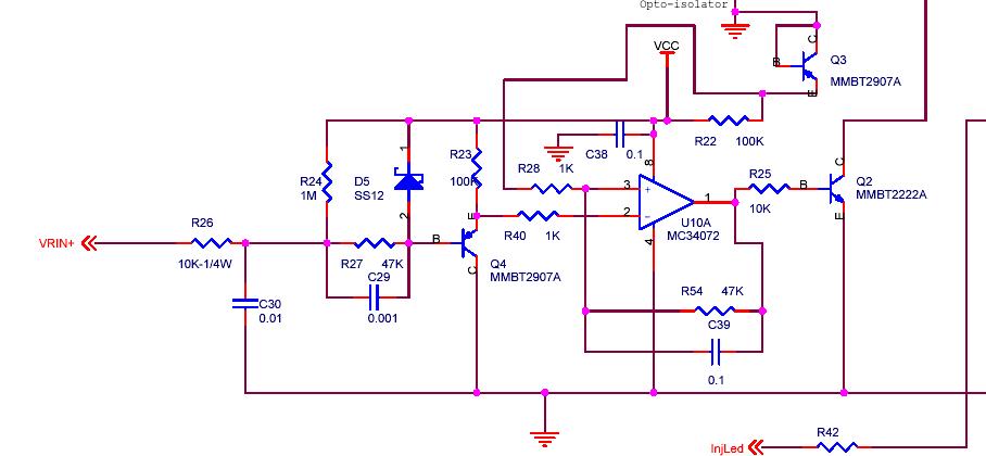

Here is the VR circuit:
There is a diode D5 which is used to shunt the VR current whenever the VR voltage reaches a potential above the 5 volt rail (VCC). This is needed to protect the transistor Q4 from emitter-base reverse voltage, and it works just fine for this purpose.
When the VR potential is below the 5V rail the diode is back-biased and is turned off. The transistor Q4 is turned on as the VR potential drops thru zero and below, it stays conducting throughout the entire negative swing.
Here's the issue - the SS12 diode has a reverse voltage rating of 20 volts, kinda weak for this application. A VR sensor can produce as much as 100 volts or more at high RPMs. If the reverse voltage across this diode exceeds its breakdown it will avalanche and conduct, and this effectively shuts off the transistor. There is a voltage-divider arrangement with the diode amongst the resistors and transistor so the breakdown is not at 20 volts but higher, however it is indeed possible. On the other hand, the diode is referenced to the 5V rail, so in effect there is a -15 volt potential on the VR before breakdown (referenced to the VR- input)....
Also, when the breakdown occurs the diode heats up. This lowers the breakdown voltage so the effect occurs at lower voltages. This is the reason for the hot-start issues that some (including myself) have experienced.
So in order to correct this for people experiencing issues (not everybody will have this problem, it depends on the VR arrangement), the fix is to replace this diode with one with a better reverse voltage rating. I have used a thru-hole diode 1N4148 as a replacement - this is a 100V reverse voltage device. luckily, the diode D5 is easily replaced:

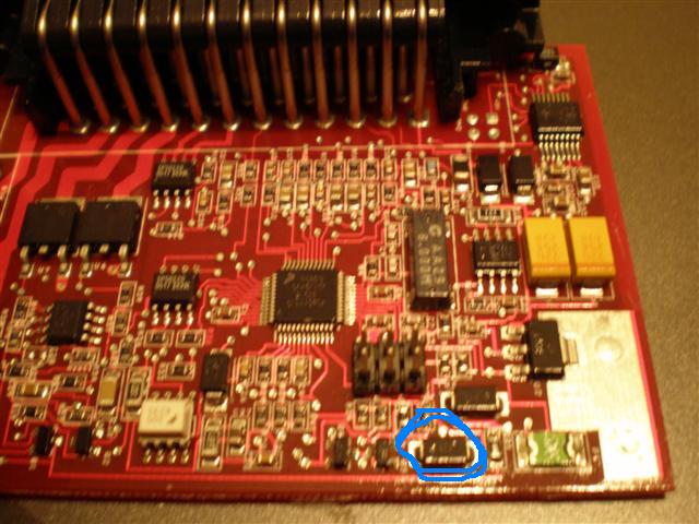

First, here is where D5 is located:
You need to remove this diode with a soldering iron. You can heat up one pad and lever the diode up in the air so that it is supported by the other pad, then apply the iron to the other pad to remove.

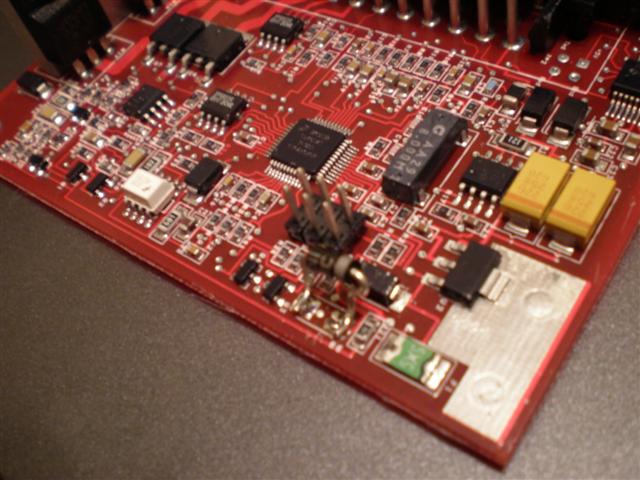

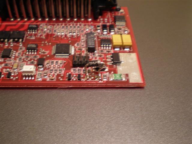

Next, bend the leads of the 1N4148 so that it fits on the pads. Make sure it does not hand off the edge of the PCB because this can short to the case. Then solder to the pads, adding a little solder. The band of the diode needs to point towards the green polyfuse device right next to it.
Here are photos of the mod:
You can use any diode with a 100V rating or above, like a 1N4004, etc. Also, if you do not feel comfortable performing this mod, send me a PM and I will help.

I looked at your schematic and can't say I'm convinced of your theory. When the VR input goes low, it's going to forward bias Q4, clamping its collector to ground and allowing no more than 2.5V BE; so it should never be possible to put more than 7.5V of reverse voltage across D5. I confirmed this with a scope.
Here's what I was seeing with this setup. I was measuring between ground and the base of Q4. The pulses are about 6V high (2V / div); ground is at the hashed center line. Notice the little nick near the end of the top edges of the pulses... at higher RPMs this nick gets bigger, eventually making enough of a notch in the pulse that I'm pretty sure that's what's killing my tach signal. The p-p of the pulses here never increase with RPM, although the VR input does increase - going up to about 100V p-p at higher RPMs.
I tried adding a 12V Zener across C30. This helped a bit... getting me to 6800 RPM. I also tried removing C30 entirely. That actually gets me to 8500RPM or so. I also tried adding back-to-back 12V Zener's in place of C30... same result, can rev cleanly to 8500RPM or so, then lose tach. Here's what 2K RPM signal looks like between ground and the junction of R26 and R27 with the back-to-back Zeners clipping the peaks at 12V (so 24V p-p).
A possible counter-theory... could the recovery interval of the diode be part of the problem? A 1N4148 is a fast recovery diode (4ns). A 1N4003 is normal recovery (30uS). What was the trr of the original diode?

SQLGUY wrote: As I mentioned there, I removed my 22K of series resistance and swapped D5 for a 1N4003. This restored my can't-rev-to-redline problem, with uS losing tach precisely at 4800RPM.
Yes, this makes sense, and I also obtain roughly the same result with PSPICE and with a corrected board, so much for the explanation. The anode of the diode should never swing below 0.7 volts (w.r.t. ground) or above approx 5.6V. However, with that said I was able, with the original SS12 diode, to achieve breakdown with only input amplitude variations. I found this with a new test engine, and I have tested at least 10 boards and they all fail like clockwork until the diode is replaced, both V1 and V2 board versions.
Reviewing the datasheet for the SS12 from Vishay does not revel a lot of data, especially on reverse recovery speed. There is a rating of 1,000 volts/microsecond which is much much faster than anything we are dealing with here. The diode is targeted to be used for DC-DC converters, high frequency inverters, and the like, again much faster than the low KHz range we are dealing with.
However, the Fairchild datasheet yielded a nice factoid:
http://www.fairchildsemi.com/ds/SS/SS12.pdf
See the "Reverse Current @ rated Vr" spec - this is the leakage current - its only 0.2 milliamps at 25 deg C .. But it is 10 milliamps at 100 deg C - Bingo. Remember this part is right next to the voltage regulator, and it was an observed thermal failure. Not sure of the amplitude part, however the failure occurred even at idle situations. Makes more sense.
SQLGUY wrote: Here's what I was seeing with this setup. I was measuring between ground and the base of Q4. The pulses are about 6V high (2V / div); ground is at the hashed center line. Notice the little nick near the end of the top edges of the pulses... at higher RPMs this nick gets bigger, eventually making enough of a notch in the pulse that I'm pretty sure that's what's killing my tach signal. The p-p of the pulses here never increase with RPM, although the VR input does increase - going up to about 100V p-p at higher RPMs.
I see the notch, in fact it is on both sides of the waveform. It seemingly appears right after the saturation point in the waveform, it just rides down lower on the steep slope edge.
I have not experienced this notch that you are experiencing, just checked the bench and engine setup with the same test. I also do not see it with the simulation. However, if I increase the value of the C29 capacitor to a large value in the simulation I can simulate the blip as well, although it takes a lot of capacitance (like 1uf). This capacitor (called a speedup capacitor) is in place to help reduce the phase shift that C30 introduces at higher frequencies - and there is interaction b/w these values. However it is a small effect and the software also can correct for this.
