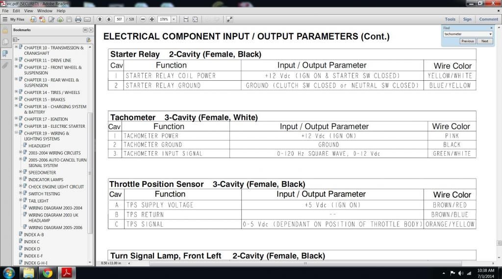

OK, dontz125, I thought, it was +12V, GND and the 0-120Hz & 0-12V were two separates, not a combined signal. Glad that's cleared up! :)
TurboVic1
Posts: 13
Joined: Thu Jun 26, 2014 3:44 am
Re: Odd Fire 50 deg V2 Project
Post by TurboVic1 »
24c wrote:OK, dontz125, I thought, it was +12V, GND and the 0-120Hz & 0-12V were two separates, not a combined signal. Glad that's cleared up! :)
Yes sir that is my tach exactly! Cat's out of the bag now lol!
Good to hear that it will work... and yes to confirm that is 3 wires. I need a little education again on pwm, but this is what told me the specs:
