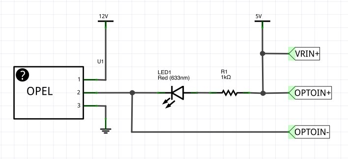

I wonder if anybody can explain something to me, my French friend, a retired electronics guru, has built a v2.2 module simulated input on a breadboard with discrete components, and done some testing.
I am using an Opel Hall sensor and have managed to get it to work OK on a v2 MicroSquirt, by reversing the OPTOIN pins, so signal going to OPTOIN-and applying +5V from Vref to OPTOIN+, but I am being told that the sensor provides a "1" or +ve signal before its triggered, so I must change the raised lug (trigger) to a solid disc with a hole drilled in it to reverse the state.

A little more info, this Hall sensor produces 0V in it's resting state (0.008 mV), and when it is excited by the steel pin or tooth 0.75 V (0.755mV).
I can reverse this behaviour if I make a disc with a hole in it for my trigger, so then it produces 0.75V normally and a 0V pulse when it senses the hole.
If I was using the module board is this low voltage going to cause a problem, as I notice the threshold voltage for VR2IN+ is 1.8V, or will the ALTCAM input be OK to use?
I assume there should be no issues using the OPTOIN+ & OPTOIN- pins with these voltage levels.
PS I need to use the "dual spark" Dual Tach Inputs in the software with my set up.

That's not a lot of voltage output; can you try addinga pull up resistor?

Matt,
I didn't have a pull up resistor or LED when I first got it working, but I do now. LED1 is just an indicator, a bit like a timing light, so when the steel pin triggers the sensor it lights up. Useful for timing in a DIY sort of way.
VRIN+ tied to 5V & pull up was c/o my French friend.
Works with v2 cased MicroSquirt & should work with the v2.2 Module board.

I am using the "Dual Inputs, Timing from 1 cam tooth", which is for a one tooth trigger and two Hall sensors 180º opposed on a cam wheel with a legacy cased v2 MicroSquirt (built in ignitors & jumpers for LLO). My Hall sensors, Vauxhall/Opel 9174621 are in a bespoke CNC machined billet, and go high (0.755mV) when triggered.
To get these to work, I used the following input circuit mods to pull up & increase the noise immunity (c/o my French friend)
Using "Falling Edge" in the "Ignition Capture Settings", I can get stable RPMs & cranking detected from 16-18000 in TunerStudio.
Using "Rising Edge" (wrong selection, but used as comparison), I get RPMs detected from 48 onwards in TunerStudio.
BTW, if you are using a v2.2 MicroSquirt Module, I use this circuit to achieve the same
input v2.2.jpg (25.66 KiB) Viewed 2297 times
