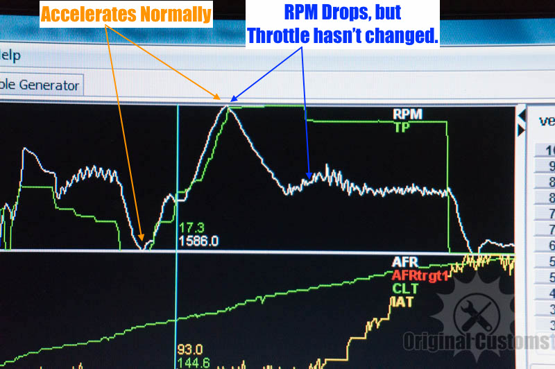

A pic of today's datalog that shows the problem. RPM drops for no reason I can find.

Re: Going Lean
My guess is it's going so rich you are getting a lean misfire.
