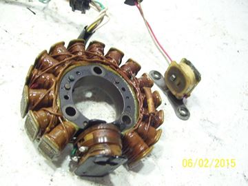

Upon further review, it doesn't look like the bike uses a VR sensor for the pulse generator-- its simply a square winding of wire with two leads coming of and so I'm back to thinking the bump (which is actually about 2 inches long) is a magnet, or perhaps something entirely unrelated.

Don't get confused or distracted by the long fancy VR or Hall sensors found on cars - on a bike, a VR sensor IS a little square winding (with a 3-4mm button nose) with two leads coming out. A quick Google for pics, and I found this:
TTR225 Stator and pickup.jpg (18.84 KiB) Viewed 17298 times
Assuming that square thingy on the right is what you're talking about, that IS a VR sensor.
A single wheel works with a single sensor, whether on the cam or crank. A dual sensor arrangement needs a separate tooth. At cam speed, it can be part of the same chunk of metal, but physically offset (stacked). At this point, I'm going to suggest just sticking with a 12-3 wheel on the cam with a single sensor.

Post by BW250 »
