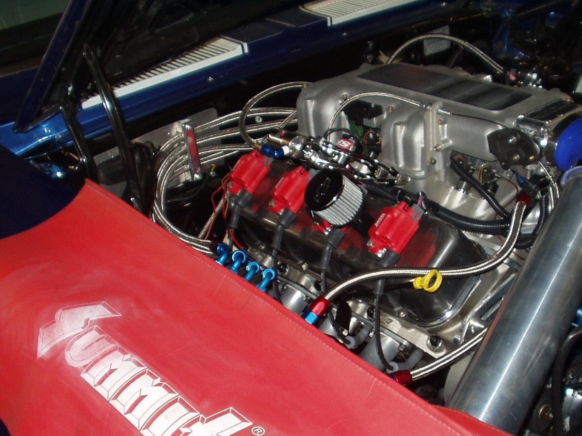

Re: More Data
Post by Joe »
This is the setup I'm using (Had trouble with attachent on other post)
Joe
(153.15 KiB) Not downloaded yet
TheMonkey
Experienced Squirter
Posts: 159
Joined: Tue Mar 28, 2006 4:23 pm
Re: More Data
Post by TheMonkey »
Good info Joe. Very nice looking setup.
