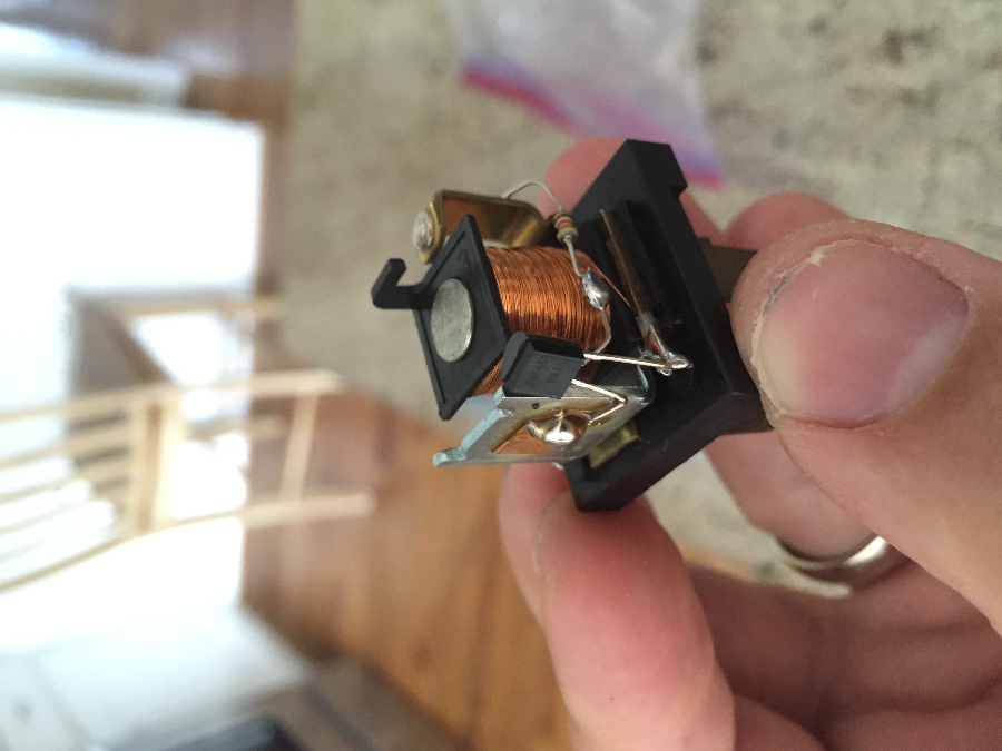

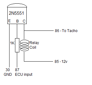

The tachometer was previously driven from the negative side of the coil. Doing some forum searches and checking out the MS hardware manual I constructed an external circuit using a relay coil and transistor 2N5551 to try to replicate the high voltage spike that I think the tach needs to run. The circuit I used is attached. The "ECU Input" is the Tach Output wire (green/yellow).
When I start the car the Tach moves a little bit and they stays at zero. Have a wired this incorrectly? Is there something I have to enable in the software to get the Tach Output enabled? Maybe there is something else I should try?
