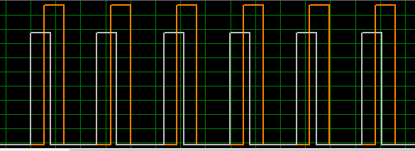

Update :
ok so now i got a signal like this on tachRef
Why cant tachRef see the 180 deg offset that seperates both signal like i see in my oscilloscope?
I mean in the picture they dont look like they are separate equally like an even-fire would be...

Still no offset showing in tachRef , but i guess that its how tachRef works...
