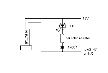

You could try wiring an LED and a 560 ohm resistor and a 1N4007 diode across one of your injectors. When the LED lights the injector is getting power and should be open. If it doesn't light up, then the injector is not getting a signal from the uS to turn on. Did you try hard-wiring the 12V from the battery to your uS to make sure the power isn't dropping off (as a temporary experiment)?
Ian.
LED on INJ.gif (1.51 KiB) Viewed 1339 times
