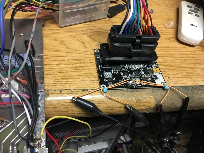

Harness Adapter Board
Microsquirt with removed components of OPTION filter and test Leads soldered in place
Input after my filter to U4 MOC205-M

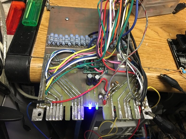

Harness Adapter Board for 1226026 Crossfire corvette
(126.63 KiB) Not downloaded yet

The Filter on the Microsquirt V3 was removed by removing R20 C27 C28 D4.
Wiring was accomplished through connector at pin 30 and pin 31 by jumping from D4 anode to pin 1 of MOC205-M U4
Replacement Filter consists of 3mm LED with forward voltage drop of 1.3V in series with 470 OHM resistor accross HEI7 module pin R to GND.
a single .001Uf ceramic capacitor is wired accross in parallel to LED resistor combo.
Microsquirt Pin 30 is wired to Anode of 3mm LED and pin 31 is wired to GND

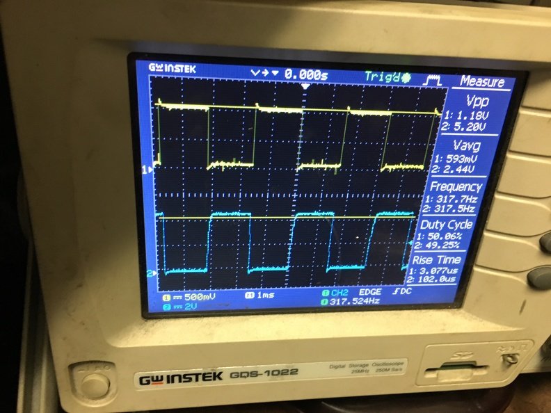

You can see that the MOC205-M has a bit of slew about 100usec on The transistor Turn Off This will cause crappy ignition signals at higher RPM.
IMO I would select a different Opto Isolator than this one.
The cheaper Generic 651 common to most UPS and Computer Power supplies is two orders of magnitude faster 5-3Usec instead of 100usec, has a 13.9KV isolation voltage so it survives a wet distributor cap discharge that I think will blow the MOC205-M at only 300V.

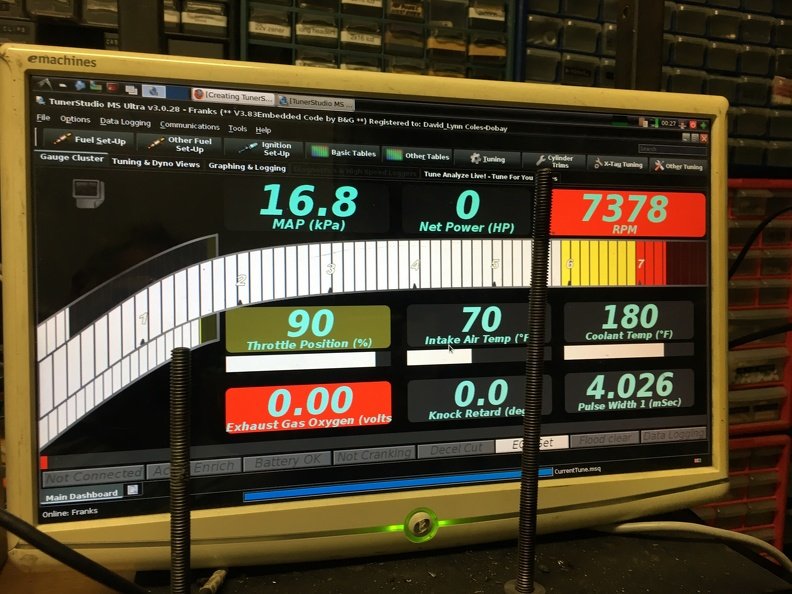

Gwinstech Function Generator injecting signal
TunerStudio Dashboard showing RPM
Signal Generator Used at 1.4Khz
(86.62 KiB) Not downloaded yet
Tuner STudio Output

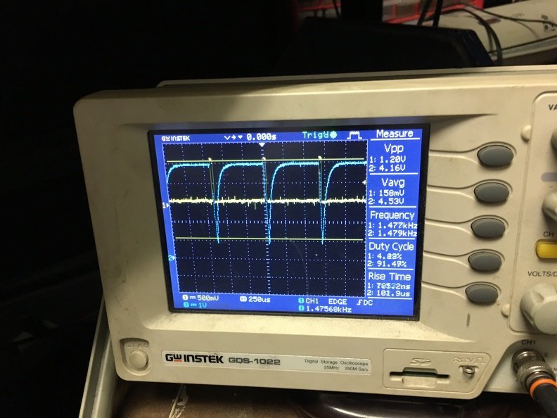

At rev limit Scope trace of signal at PW0 TACHIN
