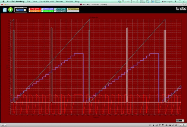

PS Don't forget the cam sensor voltage must be higher than 2.5V with a v2 MicroSquirt, but you can check this with a voltmeter. Also you can use Tachref.exe and "scope" the sensor outputs, but it is a pain having to load other software into the MicroSquirt.
PPS The other day I was using some obscure ignition software and they had this rather nice set up, which gives you all the info you require re triggering!
The red trigger wheel traces are at the bottom, the white columns are the 180ยบ ignition or tach events
