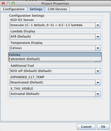

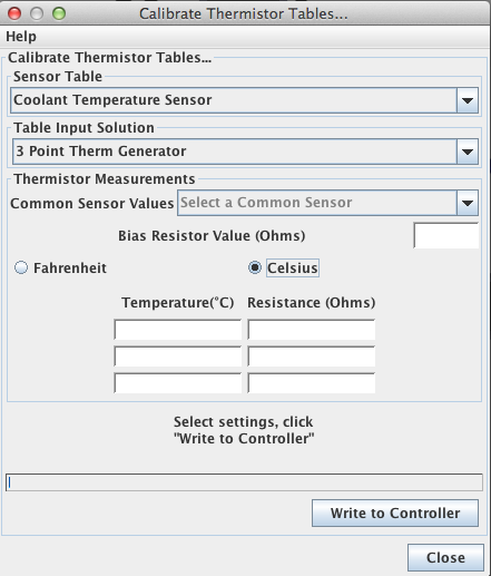

Couple of pics to help with the Celsius malarkey!
Screen Shot 2014-02-11 at 21.43.35.png (50.54 KiB) Viewed 3142 times
Then in this dialog box, click on the Settings tab

Mazda coolant temperature will be fine, the coolant doesn't know whether it's a Ford or a Mazda! :)
PS Also you can change in the Calibration window too.
(43.63 KiB) Not downloaded yet

Hi Mike
That's where I changed it in Properties, also in the sensor window, but still reads in Fahrenheit? also another question on coolant is I need to shut off the start up enrichment sooner, I assume I adjust that in the appropriate window I think default is 160F because it's highlighted in green I would like to adjust 100F how do I do that?

Re: Coolant temp problem
Alan,
re Celsius, start a new project, and import your Microsquirt controller settings, that should fix the Fahrenheit issue.
You've lost me on this one, but you can create any table values for temperature, Other Tables > Temperature Table Values in #1 to #10 boxes, then alter the ASE % & tapers so they don't add anything beyond your designated cut off temperature. :?

High Mike
Just to let you know that worked so I am reading in Celsius at last. Now trying to get my head round the WUE settings as I think the default settings are bonkers, why do they start off at 180% @ -40c ? and still 60% @ 87c ? I Know I can alter all these figures and cut the WUE off whenever I choose, just wondered why they were so daft or are they?
