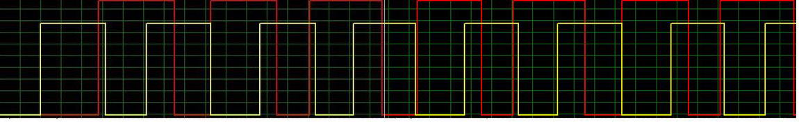

I also have attached a screencap from the Tachref program. It's a little messed up in the middle where I tried to splice the pics together.

Tachref screencap, GS1000
(48.06 KiB) Not downloaded yet
