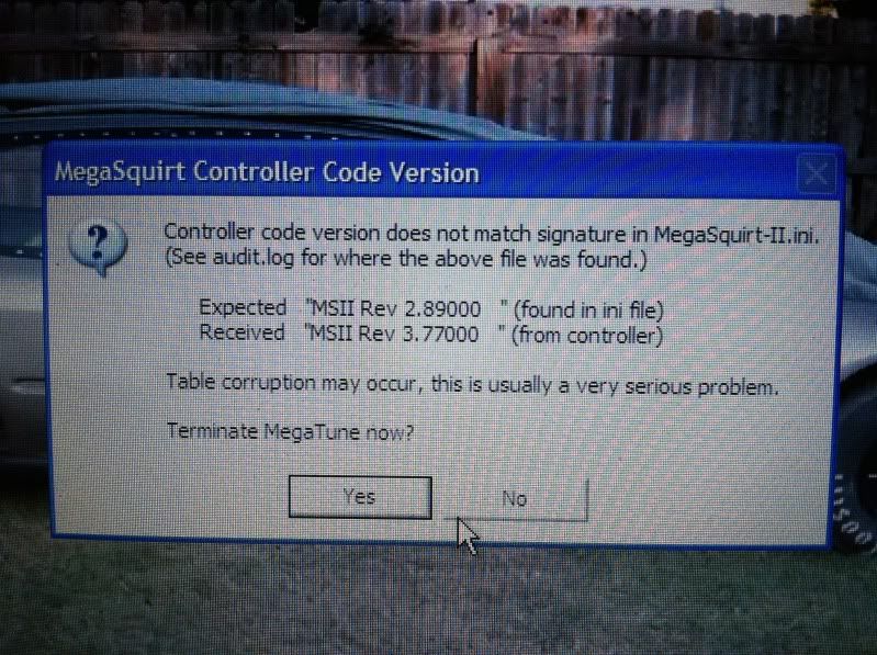

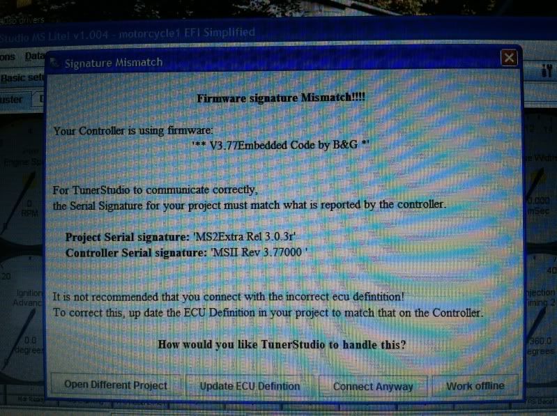

I have gotten my ms hooked up to my computer after fighting it for a week but now im getting this error ive search around but dont know what to do exactly and ive tried to pick differnet projects and it tells me that tunerstudio does not support this firmware so what do i need to do down grade?? to lower version? any input would be great thanks.
this is tunerstudio
this one is megatune

Hello I had that problem when i tried to connect , you need the new 3.770 ini file for tuner studio, i found it somewhere in mega squirt II code revision . I did that and it connected .
found it its under www.megamanual.com/files/ini/ at the bottom.
Re: Can not get MS to connect to laptop
two stroker wrote:...you need the new 3.770 ini file for tuner studio...
+1 You click on the Update ECU Definition, and if TunerStudio is new enough, I'm using the beta version, it should find the ini like mine did.
