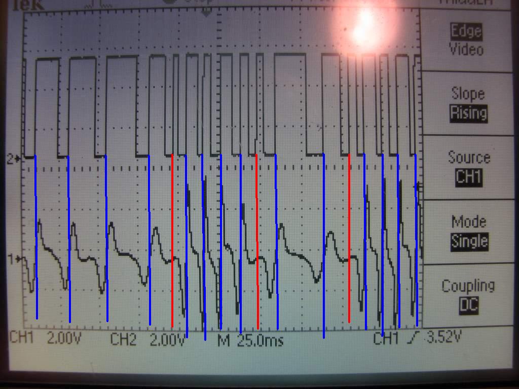

First are you getting a reliable tach? This took changing some resistors in the uS for us. Easiest way is to scope out the VR+ and tachout, watch for false pulses on the tach side. http://www.microsquirt.com/download/file.php?id=5756
If you have a reliable tach, start a maximum speed data log. This will tell you if uS thinks it has missed a tooth or found extra tooth. What you may find is that things are erroring out due to the variability in RPM. This is caused by the decompression pin on the exhaust cam and the 180deg 2 cylinder. There is a version of the code (JT3) which Grippo modified for us to remove all error checking on timing. It has worked flawlessly since.
If you look closely in that thread you might just find a helpful attachment. :idea:
