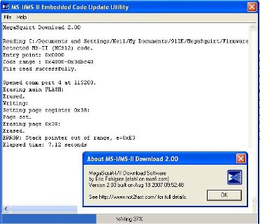

I dug out my early usquirt in a vain attempt to see if this new code would magically fix the injector driver issues :D
Any tips to get this loaded :?:

Lance, this is a microsquirt that I'm trying to bring back to life.

How early is the microsquirt - is it a red pcb ? This problem may have to do with what bootloader is on the microsquirt. All the green (V2.0) ones have a bootloader to handle the larger size of the 3.4x code. If downloading 2.90 code works, then that is likely the problem.

Yup as you say, it's a red V1.0 and the 2.9 code loads fine.
Oh well, I'm sure I'll find a use for it on something.
