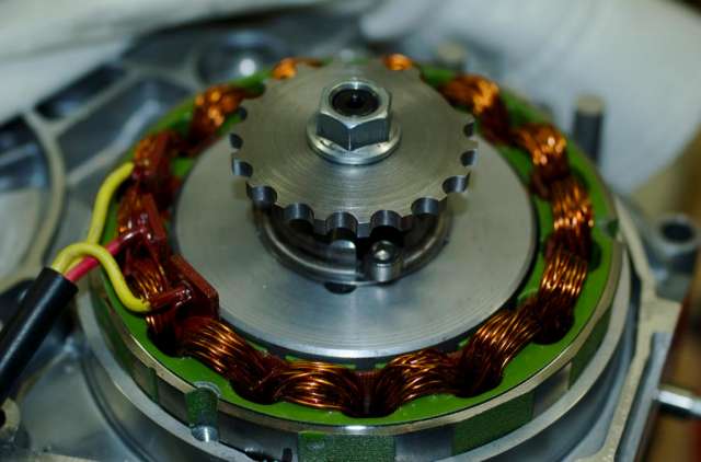

I was able to attach a 180W generator to the engine which will hopefully able to deliver enough power to feed a complete Microsquirt setup with carefully selected parts, but now I have to setup ignition first (fuel still on carb). I have manufactured a 18-1 trigger wheel and will attach a VR sensor to it (mounting bracket yet to be finished).

I've put my trigger wheel on the lathe, hooked the Microsquirt on hoping to see some meaningful values. After initially disappointing erratic display with ridicolous RPMs in the 50000 range, I managed to adjust everything until values seemed reasonable. My lathe has a switch where I can change two speeds on the fly, nominal between 330 and 660 RPM.
Megatune shows 364 and 737 respectively which seems pretty close.
I only got it to work by entering strange values as "Skip Teeth" the "Advanced Ignition Settings" dialog:
Trigger Wheel Teeth: 18
Missing Teeth: 1
Skip Teeth: 36
Delay Teeth: 0
As I understand the manual, for a single cylinder, wasted spark engine, this should be either 0 or a multiple of "Trigger Wheel Teeth".
However, I don't get tach sync at all if I enter 0, get a very erratic result with 18 and values seem to be reasonable at 36. Can anybody explain this behaviour?
It might or might not correspond with the other, more serious problem I have: when I move the belt, my lathe can do 1400/2800 RPM. I didn't manage to get tach sync at those speeds at all, no matter what I tried. The engine where I want to mount the microsquirt is supposed to do close to 13000 RPM, so a reliable tach is essential to me. I know my trigger wheel teeth aren't optimal according to the manual (it recommends square teeth if I remember correctly, but the way I have it was much easier to fabricate) - would the tooth shape have so much influence on the signal quality or is there anything else I could try to get reliable results?
I'd appreciate any helpful response.

The ridiculous rpms are probably the result of noise which you have fixed, at least at low rpms. The fact that you had to use 36 skip teeth (meaning 1 tach pulse per 720 deg) indicates you are using a sequential dual spark mode, which means you should have a cam synch, but I am guessing you want to run wasted spark. If you look at microsquirt.info, and select dual spark on the left sidebar menu, you will see a lot of good information and illustrations on setting up your wheel, even for 1 cylinder engines, and at the end there is another link to even more information which explains what all the terms mean.
We have had all sorts of tooth shapes and the car manufacturers use all different shapes. The important thing is that the sensor match the wheel, which means the small detection part of the sensor should be smaller than the tooth, and the distance from the tooth is also dependent on the the wheel size and sensitivity of the sensor. A sensor that works with a large wheel will see a large signal because of the large metal mass and therefore needs less sensitivity.
It is extremely difficult to design a circuit that works with all wheel and sensor combinations. Especially when you factor in the fact that many people make their own wheels. Generally the problem we have had at higher rpms is that the missing tooth gap produces a small bump in the middle where it should be flat. We have put in software to throw out this false bump, but it is probably not perfect, so you may have to play with resistors and diodes as other people have done. There are numerous posts on this. We are working on better diagnostics and fixes for this, but it is a hard problem and all aftermarket ECUs have problems with this. Many are sold with a wheel and sensor so they can be sure it works.
One thing that will help is to look at the rpm gauge in TS. If it jumps to 0 for an instant, it means the ECU is seeing noise on the tooth and is losing synch, then quickly regains it. There is also a trigger counter (I think there is a gauge for it) that counts up if noise (extra tooth) comes in, and counts down if a tooth takes to long to come in, based on the time between previous teeth. The last would mean the signal is too weak, so move sensor closer to wheel. In the datalog, there is also a deltaT that measures the time between teeth in microseconds - this is what the ECU is seeing, so on a lathe at steady speed the times should be close.

grippo wrote: We have had all sorts of tooth shapes and the car manufacturers use all different shapes. The important thing is that the sensor match the wheel, which means the small detection part of the sensor should be smaller than the tooth, and the distance from the tooth is also dependent on the the wheel size and sensitivity of the sensor. A sensor that works with a large wheel will see a large signal because of the large metal mass and therefore needs less sensitivity.
Thanks a ton. Advice from the guru is gold, obviously :D . I changed sensors from this
(automotive sensor probably meant for cars with larger wheels)
to this
(Nippon Denso sensor used in small motorbikes)
and that fixed sync problems instantly at all RPMs my lathe is able to do (even 2800 RPM is now steadily displayed at 2820 without any counter reset when changing speed).
grippo wrote:The fact that you had to use 36 skip teeth (meaning 1 tach pulse per 720 deg) indicates you are using a sequential dual spark mode, which means you should have a cam synch, but I am guessing you want to run wasted spark.
It still only works with skip teeth = 36 (18=RPMx2, 0=erratic behaviour), although I double checked that I have disabled dual spark mode (I do in fact want to run wasted spark). Do you have an idea on how to fix this? Does it matter at all - what if I just leave it since it seems to work?
