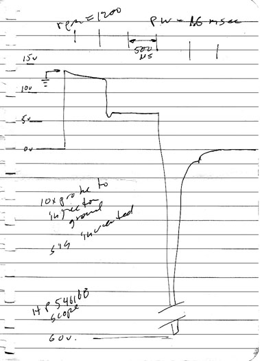

I'm attaching a sketch of the oscilloscope trace I get at idle. I'm no electronics expert. In fact, this is only the second or third time I have ever used a scope. The scope probe is on the negative lead of the injector, which is the side that MicroSquirt pulls to ground to open the injector. I inverted the scope trace because it seemed to make more sense to me that way. The thing that concerns me is the spike at the end of the pulse. It goes to 60 volts above battery voltage (14.5V + 60 = 75V). Is that a problem, or can I ignore it? The spike is only 20 volts above battery voltage when the stock Chrylser controller is used in place of the MicroSquirt.
The shape of the pulse doesn't change as I increase the rpm. I assume that is good. The pulse width does get longer, and seems to agree with the value displayed in MegeTune.

I tried raising the ve in the 4000 - 4500 RPM range, but it didn't seem to have any effect on the problem. I asked my neighbor to come down with his digital camera and stand last night. While I raised the RPM in increments of 500, he took a shot of the scope trace and recorded the PW as I called it out. I did this twice, with seven images each time at 1400, 2000, 2500, 3000, 3500, 4000, and 4300 RPM. The first set of images are at scope settings of time = 1ms/div, and amplitude = 20V/div. The second set is at 5ms, 20V. I will attempt to attach those images to this message.
I've been concerned by three things that I've see on the scope trace. The first is the rather large voltage spike when the injector closes. It is in the range of 70 - 80 volts. Second is the second injector pulse that appears to the right of the main pulse in the 4000 RPM range. The third is the apparent discrepancy between the PW value as displayed in MegaTune and the length of the pulse in the scope trace as the RPMs go above 3000.
I also have scope traces with everything hooked back up to the stock Chrysler computer at idle and at 4000 RPM, and a datalog of the MicroSquirt test. I will attach those to another message following this one.
It looks like I may have a noise problem at this point. I have been careful to use a common ground point on the engine for all MicroSquirt and WB O2 sensor grounds, and the ignition control and fuel injector wires are routed separately from the signal wires.
