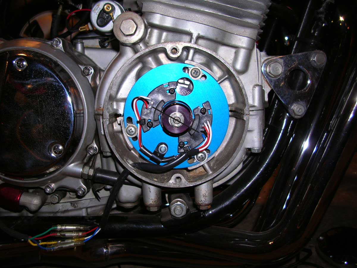

Well by looking at it, they looked 180 apart. When I drew a line through the photo you can see they are not, so there is one problem. Not sure if I have enough adjustment to compensate. If it is inverting one input that could also be a problem. This could explain why it looked like it one channel was capturing rising edge and the other trailing. I will have to measure how many degrees the it is from leading to trailing. But it does not explain why the 2nd channel offset could not fix it. Will see if I can get the sensors 180 apart and log again.
(110.63 KiB) Downloaded 22 times
The sensors need to be placed where the engine wants them - if this is an odd-fire engine then they should be positioned to reflect that. But if it is even fire, then yes I would try to make them 180 deg apart. But i agree - we haven't explained why the offset doesn;t help - but once you determine what the offset should be, then we can run it with that offset entered in the data and, if it is still not right, see what the timing variables tell us.

The trigger mounts are not adjusted the same in their slots, if you even them up you may have 180 degrees. I can't see how it can't be 180, I doubt Honda changed their crankshaft to be offset some degrees.

This all looks consistent and shows what I expected. Both inputs and outputs show varying time differneces: roughly 636 and 960. If you add them up and multiply by .128 you get 204 ms, which is the time for 1 rev at 294 rpm. It's shows me that the spark outputs are reflecting the inputs and that the inputs are not coming in every 100 ms (spare 4 always around 781 or so) like they should, but they are in fact offset. This could be for several reasons. I notice in the picture that the sensors don't really look the same. If their polarities are different, then that would explain it. I know the Dyna 2000 works, but that is because the circuitry in that is designed for this and compensates. Or it may be the opto gives a different polarity - I will ask Bruce to weigh in on this. Or it could be that the wires on one sensor need to be reversed or it may be that where you think it is detecting/ zero crossing is not really where it is. If you just run the first data (-320 offset) but move ONE sensor in ONE direction, and rerun, then you should see the spare4, spare5 numbers either get closer together or further apart (like 500 and 1100 rather than the present 636, 960). You are trying to get both numbers to come out to around 780 for 300 rpm. That is, the spare4 column should have all it's number near 780 and likewise for spare 5.
