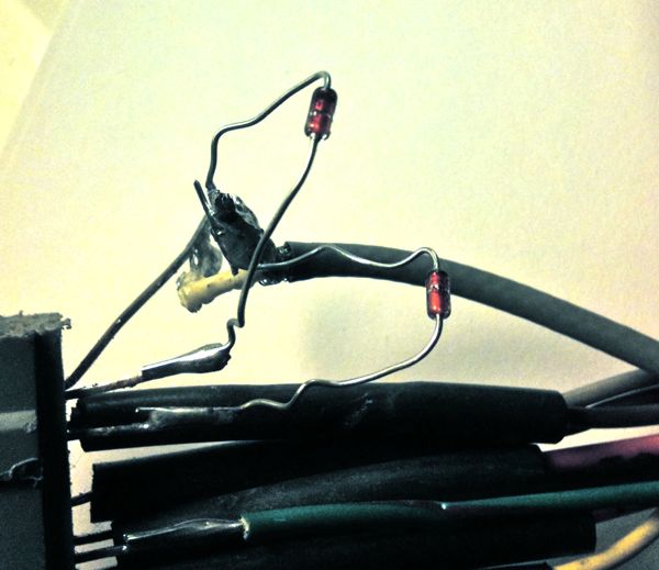

Excellent, you have the same issue I had with TachRef.exe not showing a cam sensor plot on VR2 (yellow)...when I did sort out the voltages which were lower than yours, I had to use two diodes one on each VR input to get my bike to run with B&G 2.890.
I used a couple of 1N1007s, and I will take a picture of the orientation, but the unit is not accessible at the moment. From what I remember, if I placed the diode one way round it blocked the signal (polarity issue I think) and the other way it made no difference on the crank VR, and the same for the cam VR2 too. They have to go back to back a bit like half a bridge rectifier and the common connection is the VR sensor ground pin 33?.
Good luck buddy. :)
Re: CX500 Turbo RPM wrong
I have found a picture of the two diodes, when I was getting pretty pissed at sticking various components on the co-ax with the soldering iron. Some healthy snot on there... :oops:
[img]two_diodes.jpg[/img]
You can make out the orientation re the VR sensors and the co-ax ground wire.
Two diodes on VR1- & VR2- on pin 33
