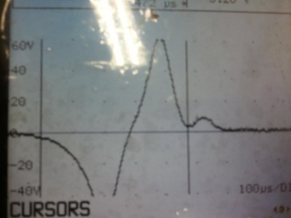

I went to the sync signal, and looks ok until about 3000 rpm, it starts to develop a funny "ring back hump" (I call it), and develops more and more pronounced the higher the revs go, untill 4600 rpm, it almost reaches the ground reference. I will post a shot of the scope just at 4600, where it breaks up. Could this be a problem? causing a double trigger on the sync? I only have the typical automotive shop type digital storage osciliscope, and could never get all the events of one rev on a screen and be remotely ledgible, but really dont see the pattern break up, just develops that ring back hump more the higher the revs go.

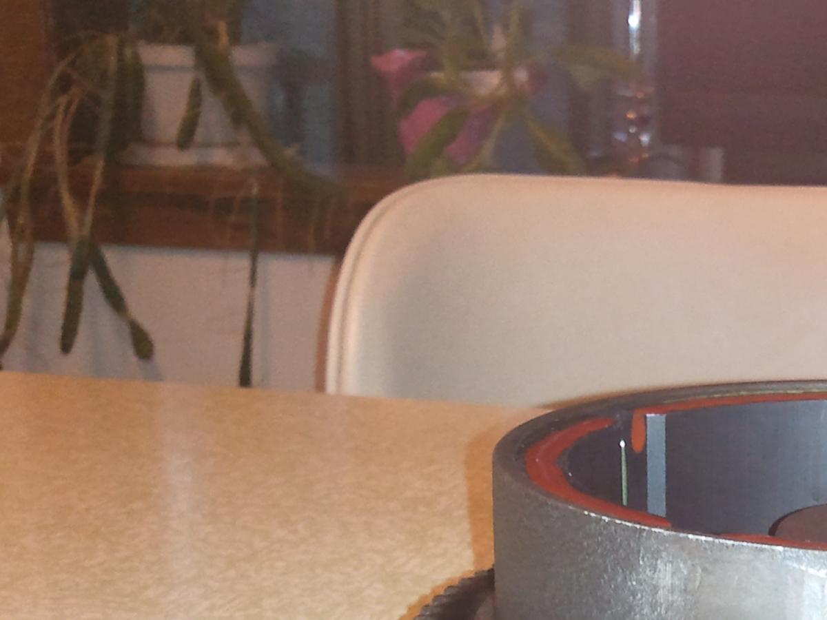

The sensor for the sync has a funny resistance of only 100 ohms, seemed really odd to me, as I am used to 600 to 1200 for most automotive VRs. The only reason I used it was because it was there, all set up, I just narrowed up the very wide hump it used on the flywheel. See picture. The trigger hump is very clean and consistant for and aft of the sensing element track

Here are the pics I wanted to post above, but had to reduce the size to post them, so here they are
flywheel I'm using, showing sync hump
(75.51 KiB) Not downloaded yet

OK, those are now junk pics, lets try this
screen shot 4600 rpm
(47.34 KiB) Not downloaded yet
Re: single cylinder, waste spark, random sync and ignition t
That last picture is what it looks like when a missing tooth wheel runs into this problem at high rpm. That could definitely cause your problem if it makes the triggers occur between T84 and 85 and then again bet. T1 and T2. Then with Cam_Tooth = 85 it would get thrown out in both cases. It would cause no problem with cam T = 0, but we know that messes up starting. But it might work with cam T= T84 and still not mess you up during starting.
