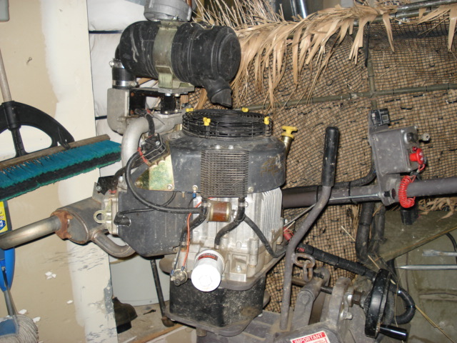

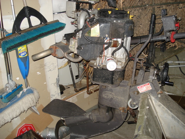

here's pics of my microsquirt candidate
prodrive 002.jpg (147.19 KiB) Viewed 1875 times
prodrive 001.jpg (151.12 KiB) Viewed 1875 times

this is where I'm thinking of mounting the unit.
A shot of the intake man. . The two little rectangle ,boss looking things might be a good plce to mount the injectors

and one overall pic of the unit
