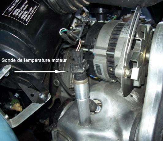

Same idea as yours, this guy fits an aluminium tube to an rocker spring cover, which is threaded to take a CLT sensor. It works well too, and gives a closer approximation to the cylinder temperature, than an oil based sensor that's cooled by air passing over a sump, like I did!
So my recommendation davecara would be look for a suitable location with a screwed in plug, and establish the thread size, and go trawling for a sensor. An IAT will work the same BTW.
