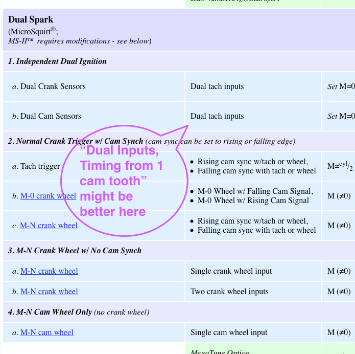

The ecu can distinguish between a crank wheel and a cam wheel even in dual tach inputs mode - there is an option further down "Dual Inputs Timing from 1 cam tooth". This is the same logic as "Dual Inputs" but tells the ecu where the wheel is mounted.

grippe wrote:The ecu can distinguish between a crank wheel and a cam wheel even in dual tach inputs mode - there is an option further down "Dual Inputs Timing from 1 cam tooth". This is the same logic as "Dual Inputs" but tells the ecu where the wheel is mounted.
Sorry Al, I honestly thought the "Dual Inputs Timing from 1 cam tooth" was for a crank & cam sensor combo, and I do read the manuals... so that's really useful info...off to test now.

UPDATE & EDIT
The RPM is doubled and so now the camshaft sensor speed readings I was getting are truly crankshaft engine speeds,
RPM detection from 23,36 & 48 to 8000 RPM, no resets ... fantastic :yeah!:
Thanks very much, it's always the simple things & boy do I have some simple moments! :)
