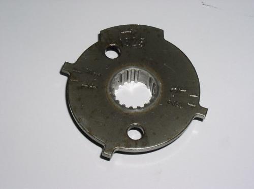

I did some digging and browsing and googling, and I came up with this pic for a pulsing rotor for the older ZX9R:
ZX9R Pulsing Rotor.JPG (13.38 KiB) Viewed 7343 times
This is the 1-long + 3-short trigger pattern so beloved of the Japanese OEMs in the 80s and 90s for use with their edge-detecting circuits. Unfortunately, because of the long trigger tooth, the uS and MS with their zero-crossing detector circuitry are effectively unable to make heads or tails of this wheel. This link gives a very good explanation of how VR sensors work, and why long teeth confuse the heck out of zero-crossing detectors (about half-way down the page). This error is unpredictable and constantly changing; when the trigger can occur anywhere in a 30deg span, it's unusable.
Fortunately, a clever lad going by Matt_GSXR figured out how to build 1) an adaptive circuit, and 2) a code patch to use that circuit; the link is here - note that this uses the MSExtra code, and if you want to discuss this possibility further it'll have to be on that code's forum.

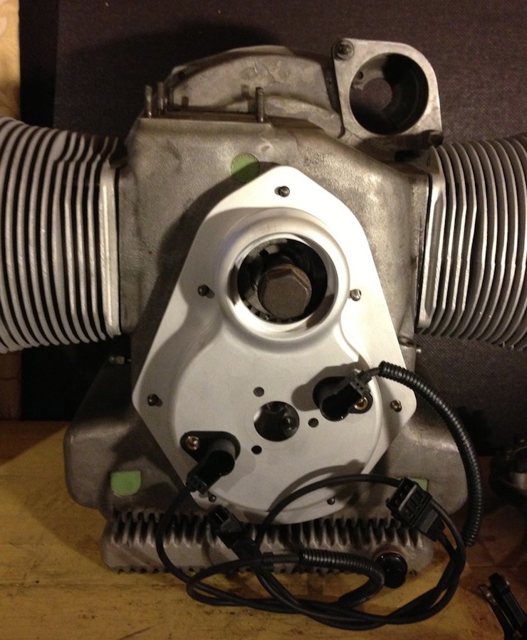

and I just like to add, that it's not just MicroSquirts that are affected by long teeth and simple VR sensors. Using a Hall effect sensor with discriminatory circuitry can overcome this. I have been using an Opel crankshaft sensor, that is positional sensitive, so if you have the rotation one way, and the sensor in one position you get two edges detected with a short or long tooth, but if you rotate the sensor 180º or reverse the shaft rotation, you only get one pulse for the first edge. This gives a very good trigger arrangement that seems to be insensitive to speed of rotation, so that it'll work off a kick start and also at 20000 rpm.
As some have noted before, these can be bulkier, but they are getting smaller all the time in the automotive world. I am not up to speed with latter day motorcycles OEM equipment, but I believe the Yamaha R6 had a Hall effect cam sensor, which was smaller. The Opel part number is 9174621 and is on fleaBay with a search, mine cost under £10 each inc P&P.
Panhard engine converted to camshaft sensing
