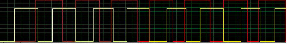

I used the tachref program tonight and didn't realize there is no way to save the output. I did a couple of screen caps and tried to splice them together. If I can attach a JPG, I'll do so.
There is some distortion about halfway through where I tried to splice two pics together. The red line is from the 1-4 pickup and the yellow one is from the 2-3 pickup. The red one seems more uniform. I'll have to read and see what they are supposed to look like, and if they are to overlap at all.
Tachref file, 5-6-13, GS1000
(48.06 KiB) Not downloaded yet

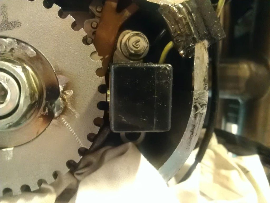

I think you have done the right thing by getting rid of the second pick up, I am running spark only at the moment on my ZX9r motor (very similar engine).
Try and get the trigger wheel welded on at TDC or as near as, it will make your cranking advance easier to tune. I ended up breaking my starter chain ! So moved the wheel to TDC. (I thought it was at TDC but turns out it was 8deg BTDC)
Here's how I fitted my 36-1 wheel I bought from "trigger wheels.com"
