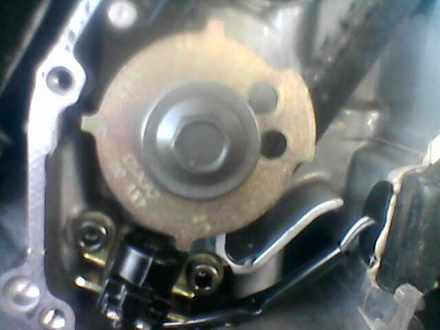

converting my 98 r1 to microsquirt. finishing up the install. it has two coils (4cyl) wasted spark. has a vr sensor , it has 4 teeth sort of. 3 are small and the forth long. was reading where someone cut down the last to match the other 3. my other thought was to see if it were possibly to run an 02 wheel (factory efi) that has 8 teeth. here's a pic... getting warm here in the N.E. :yeah!:

The B&G VR hardware does NOT like "long-tooth" wheels; the bike OEMs used to like edge-detection, while the various B&G versions are meant for zero-crossing detection. See a diagram about halfway down this page for the problems encountered.
If you can fit an 8-tooth wheel from another year, cutting one tooth off of that would probably be your best bet. The other option might be to use the wheel you have now with Matt_GSXR's "long tooth" patch to the MS2/Extra code; an adaptor circuit is needed. The code patch is here and the circuit can be found here; I don't know if the patch can be ported to the uS code - probably, but by someone a lot more code-savvy than I ... :lol:
Cutting off the long tooth of your current wheel would leave you with a 4-1 trigger wheel. This is the minimum for a 4-cyl, but it's a pretty thin minimum, especially for a high-revving powerhouse like yours. Trimming the long tooth back to a short tooth will leave you with a 4-0 wheel that won't actually provide enough info to the uS to accomplish anything. Unless you add a cam position sensor ...

thanks.. gives me some direction. going to buy the o2 crank wheel and go from there. seems the most logical choice. :RTFM:
