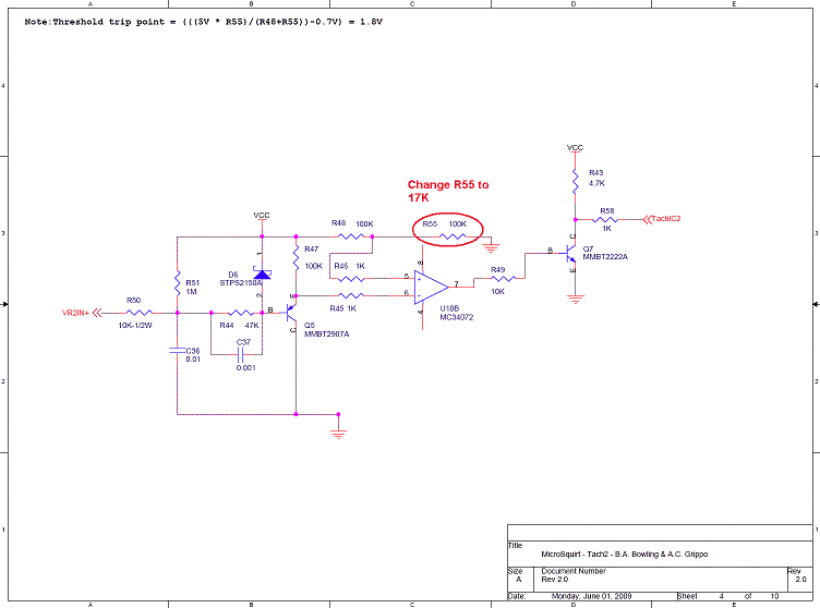

What i am trying to get at is to see if I can modify the existing VR circuit in the Microsquirt to lower the transition voltage offset. I just found the circuit diagram for the VR2in+ conditioning circuit, I didn't realize that was available. It looks like I can change either R48 or R55 to make the threshold trip point whatever I want it to be.
(13.91 KiB) Not downloaded yet
Changing R55 to 17K would make the threshold trip point close to 0V, would this work?

I changed R55 to an 18k resistor and put everything back together and ran the trigger analyzer, looks like it works now...

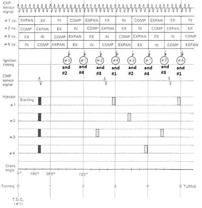

I think that the YZF and the GSXR set up would be very similiar, I have a good cank and cam signal now but I am not sure about how to configure the ignition options, what dual spak settings did you use? Rising Cam Sync with Tach or Wheel? or M-0 Wheel with Rising Crank Sync? I am having a hard time understanding which one to chose and the differences between them.
Also, do you use the Offset for Output #2 at all for an engine like this or should it be set to 0 ?
I've attached a timing diagram for the stock engine, everything is the same now except that coils 1 and 4 fire together and coils 2 and 3 fire together. Also the Vr signals that are sent to the microsquirt cross zero going positive whereas on the GSXR diagram they cross going negative (not sure where this comes into play) With this timing diagram and the trigger analyzer results I should be able to figure out all of the ignition configuration settings right? Maybe I can get a little help because what I have tried doesn't seem to work.
(57.33 KiB) Not downloaded yet
Re: Cannot use VR2in with VR on cam b/c of transition offset
Try this link and see if it helps: http://www.megamanual.com/seq/multichannel.htm It was written for the Sequencer, but the definitions and concepts are the same for microsquirt.
As far as the Offset for output #2 - leave it 0 unless you have an odd-fire engine.
