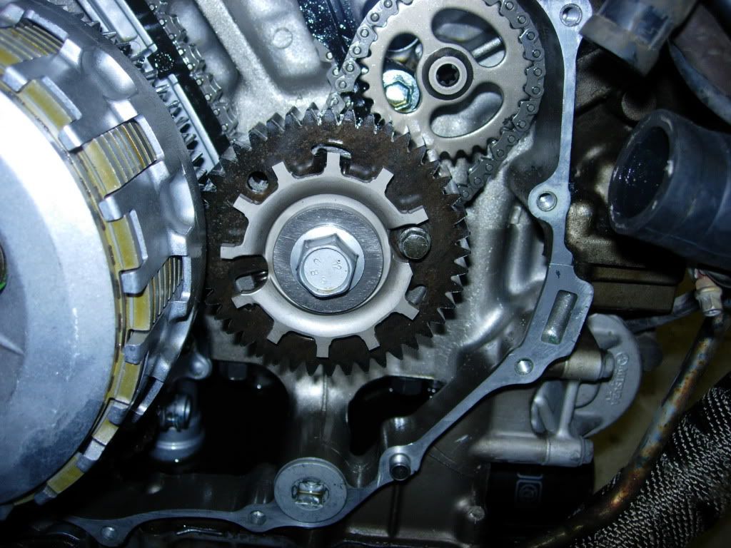

I'm running a 12-1 tooth wheel with a VR sensor at the crankshaft
a single tooth cam Hall type sensor fed by 5V vref
I saved the VTR CDI module from the bike, it trigger nice sparks but ditched the control module.
I use dual tables since the rear cylinder likes a richer mixture
I run the Hybrid alpha-N blending from 2300 to 3100 rpm, this is why the VE tables are weird, the bike drives like a charm but does not make it's full power yet, I may work on the engine a bit before I turn up the boost
