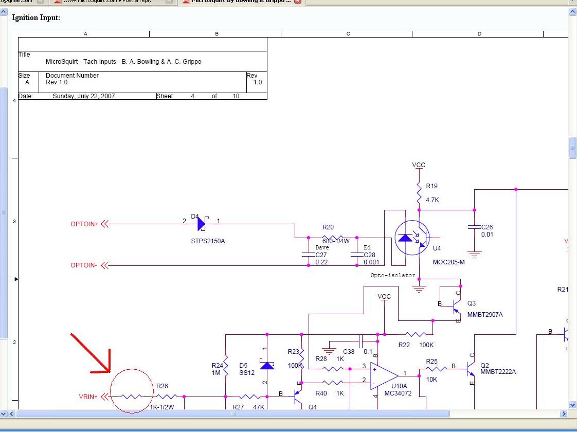

Bruce....Earlier in the year you said a few things and I just wanted a check before I make these changes. Currently we have a 10k resistor inline with the VR+ lead.
If I am reading the schematic correctly there is already a 1k (R26) resistor on the VR+ input. The resistor inline is a 10k resistor. Could I replace this (R26) with an 11k and have the same effect so I do not have to have my resistor inline in the wiring? I have a picture attached of this. This should be perfect as I see it in the schematic.

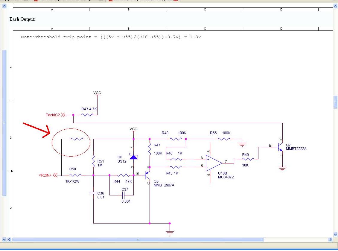

Also I notice there is a 1meg (R51) resistor on the VR2+ Cam Lead. We are currently using an external resistor to draw that line up (10k) because our cam square wave has a very substantial charge time constant using just the VR2+ input. This resistor is wired between VCC and VR2+. Could I replace this 1meg resistor with say a 50k (?) resistor and have the same effective output? I am not entirely sure about this one, this is why I would like your input.
The ideas above are proposed to replace what I currently have which can be seen in the attached pictures.

geoffct wrote: If I am reading the schematic correctly there is already a 1k (R26) resistor on the VR+ input. The resistor inline is a 10k resistor. Could I replace this (R26) with an 11k and have the same effect so I do not have to have my resistor inline in the wiring? I have a picture attached of this. This should be perfect as I see it in the schematic.
Yes, you can replace both resistors like you indicate, you will have the exact same thing!
