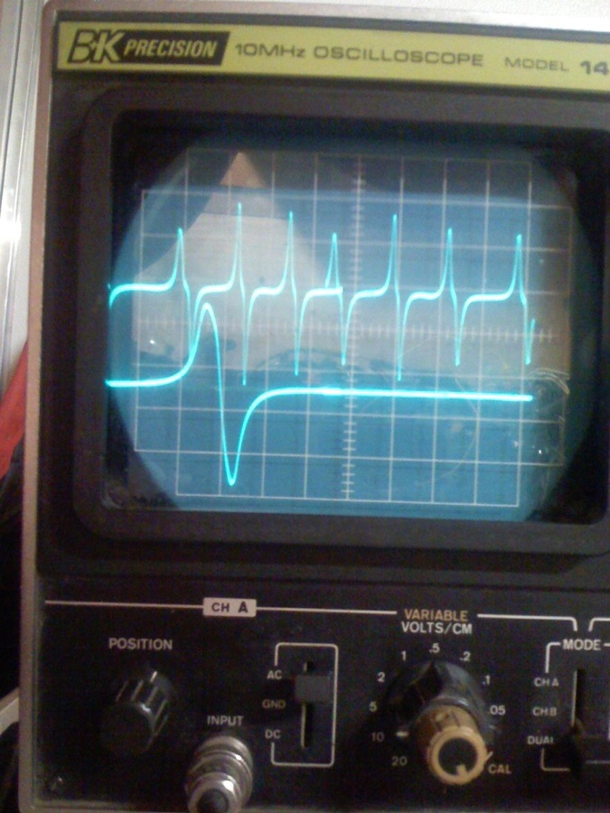

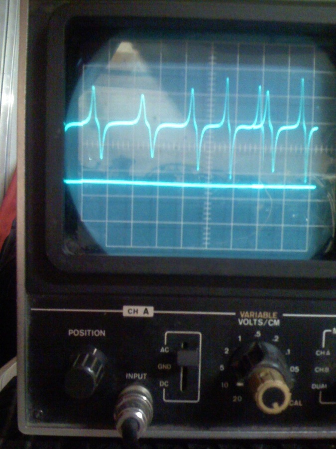

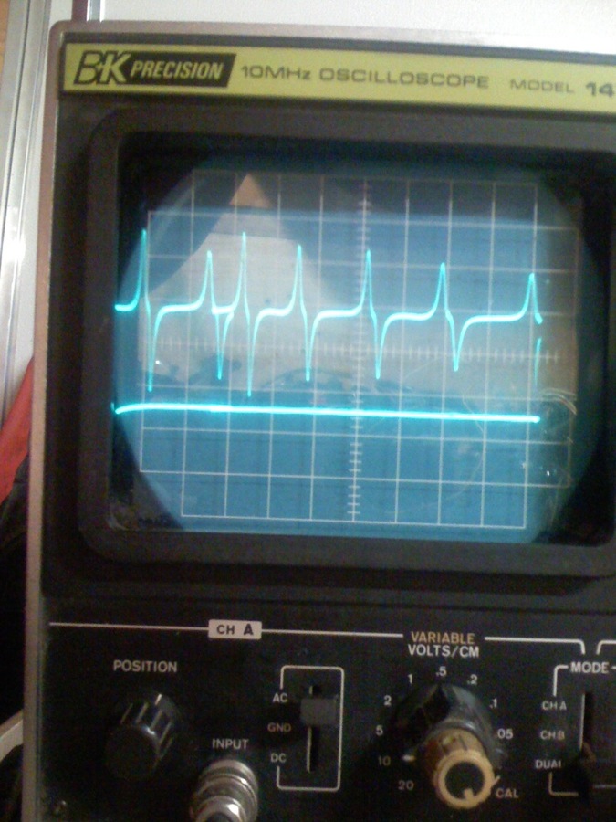

Ok. i got my hands on an ancient 10mhz scope that looks like it's seen better days. I unfortunatly couldn't get a full cycle into one screen as the scope couldn't go that slow... and actually show a usefull image. the trace just wouldn't lag long enough. But, here is what i was able to capture. I think it's mostly useless as you cant count all the pulses. ... also, the pictures where there is noise on the lower (cam trigger) trace are captures when i have the microsquirt plugged in to the harness (but not powered up).
The thing that i noticed, is there looks to be an extra tooth in the crank wheel... you'll notice two pulses right next to each other. ... is this what's messing me up?
Unfortunately, to get physical access to the crank wheel, i have to completely remove the engine and disassemble a large oil reservoir and the oil pumps which is a big pain in the arse.
Let me know what you guys think.
Thanks.

taking a look again, i may not have an extra pulse.... now it just looks like the trace was overlaping itself at that point. but, i'm still confused.
The 3rd plot definitely looked like overlap rather than an extra pulse. But you are in the best postion to judge that - you can watch the pulses go by and look for missing or extra pulses. But what I would do next is to look at the pulses going into the processor - these will be nice square waves and it is much easier to see if something is going wrong.
