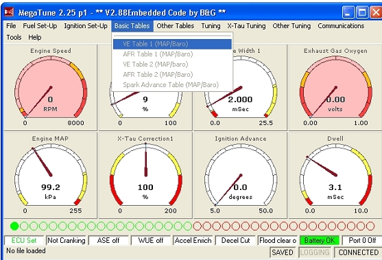

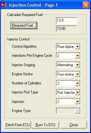

I have loaded the newest firmware into my brandnew MicroSquirt. But I have no access to the basic tables via Megatune 2.25p1.
Communication to MicroSquirt works. ECU type is set, Injection control parameters are also set except of the 'Engine type', which is not accessible too. See attached screenshots.

the megasquirt-II.2.8, the settings.ini are the latest version 2.881 (just fetched them today).
I am moving not from the 2.88 version, but from 2.867 which was delivered with the MicroSquirt.
Would you suggest to start frm 2.88?
Strange is also that the software does not see the cam trigger signals (Hall sensors). The hardware is ok.

that was the perfect hint. In my settings.ini the MAPbaro was set. So it was an easy fix. The tables are accessible now.
