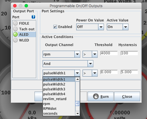

Is this the best way to deal with the VVT solonoid?
Im planning on activating the VVT solenoid above 4000rpm and when under load as per the pic. Not sure if this is exactly the best conditions to use or is there a specific VVT function in microsquirt?

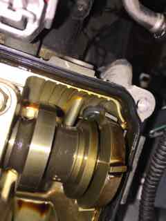

Also, trying to sort out the crank and cam position sensors. I have seen the cam sensor wheel, 1+1+2+2 as per pic. Does anyone know about the crank on these engines?
MikeC

Re: M15A (Suzuki Swift) with Microsquirt
MicroSquirt does not have a VVT function, but the programmable on/off outputs will work for on/off VVT just fine.
I'm afraid I can't ID the cam sensor pattern from the picture.
