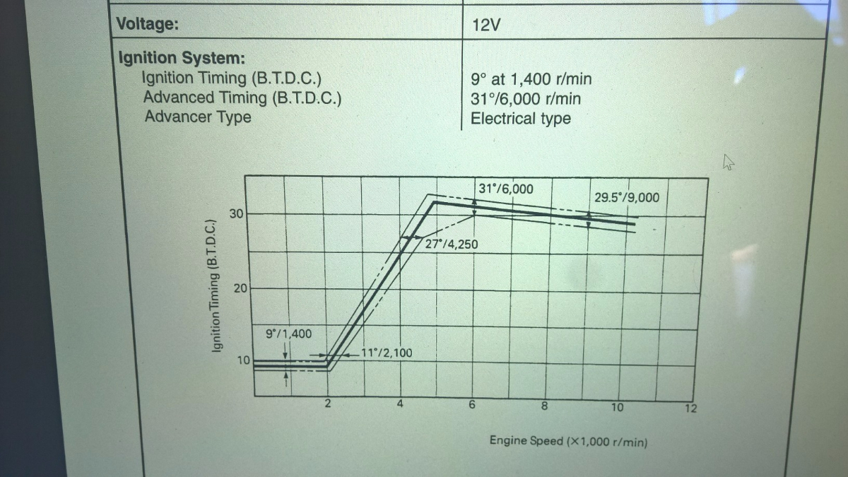

I'm assuming you are just talking about the voltage regulator? Here is the ignition timing table, is that the same thing you were asking for?
(737.66 KiB) Not downloaded yet
