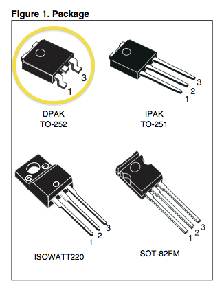

the subject says it all i do know that its a vnd5no7, when i search under digikey's listings there are still like 10+ items it can be. if someone could give me the exact part number that would be nice. one of my drivers fried from too much duty cycle :(

This info is at www.microsquirt.info > Hardware , and if you clicked on the VND5NO7 link you'd have seen this. A quick look at your board and the one circled in yellow is what you are after.

497-2481-5-ND
It help if you spell it correctly - juhanis and 24c, you both typed VND5NO7, vs VND5N0... :P
