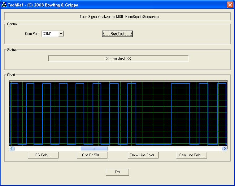

I ran the tachref.exe program and have included a jpg shot of the results. it looks good to me but anyone else????

Hey thanks, was there that much code difference in 3.430 or is it just layed out easier in the configuration? Hey Grippo did you look at my tachref diagram above? Does it look proper?
Re: Need some help with this Vtwin....please!!!
I don't think there is any difference in the code for your configuration, most of the changes were for the sequencer. But I think the ini file is better laid out for dual spark stuff.
Yes I looked at your diagram and if you measure the distances between falling edges (that is all the ecu sees is time differences between falling edges) you will see that you get a sequence like t,t,3t,t,t where t is the distance between regular teeth. This is what you should see for an N-2 wheel. You can do it by marking off the edges onto a piece of paper. But there is some variation because the engine has to compress air and then it expands.
