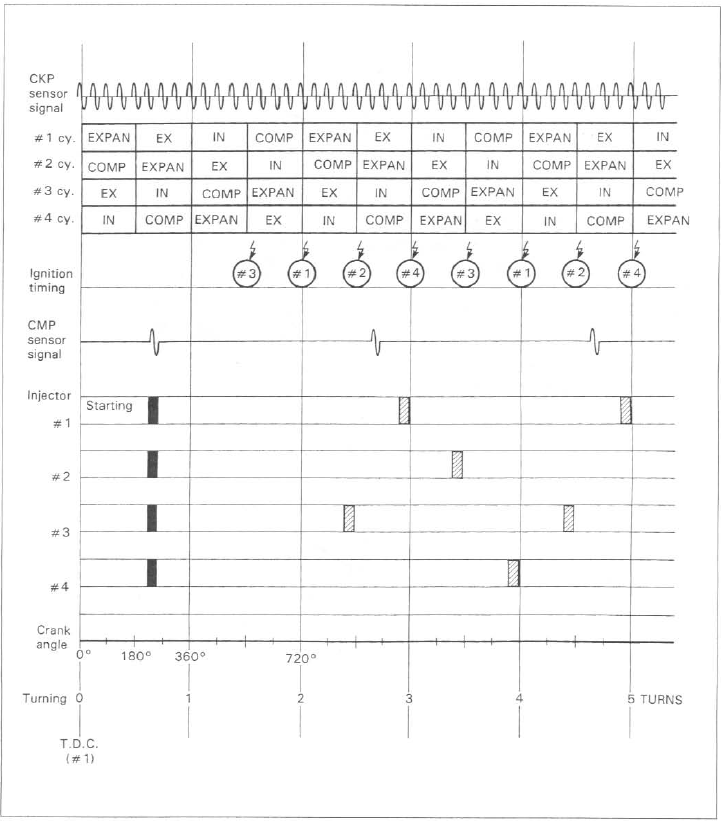

Timing from engine manual
(185.99 KiB) Not downloaded yet

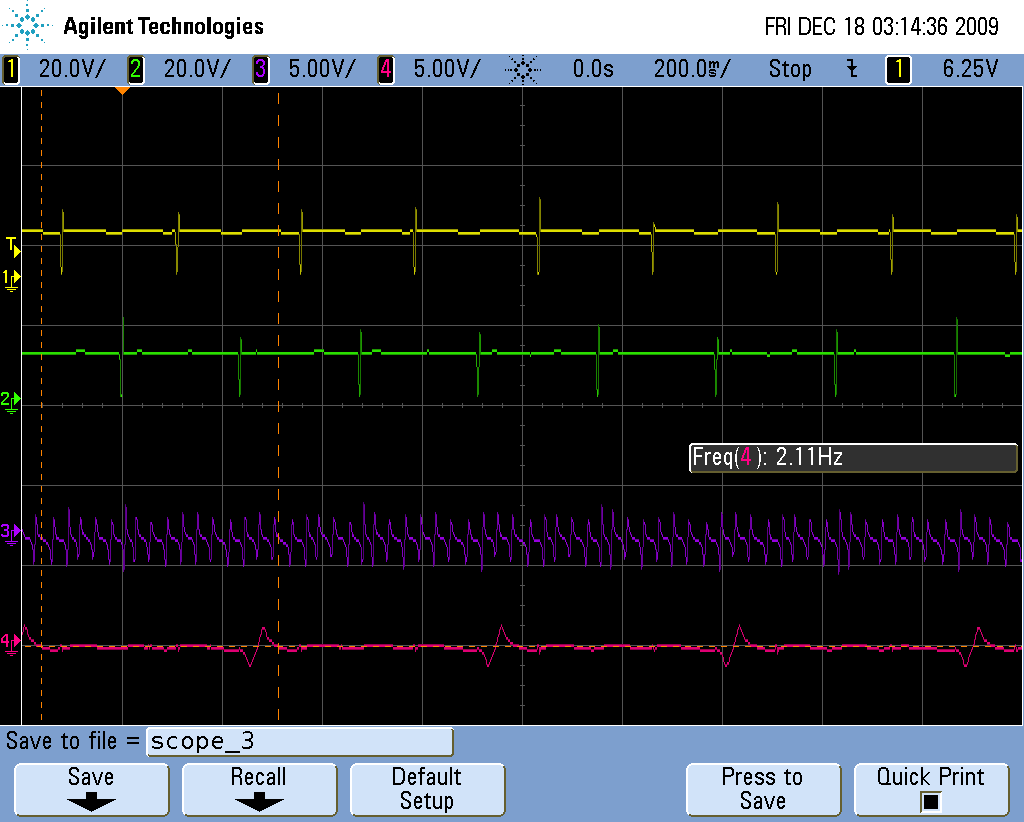

Spark output on scope... Channel 1 is IGN1, 2 is IGN2, 3 is Crank VR, 4 is Cam VR... ECU is configured the same as within the post above.
(36.96 KiB) Not downloaded yet

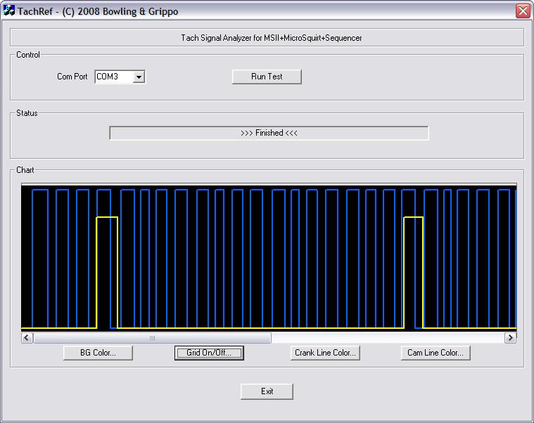

Tooth analyzer output
(69.31 KiB) Not downloaded yet

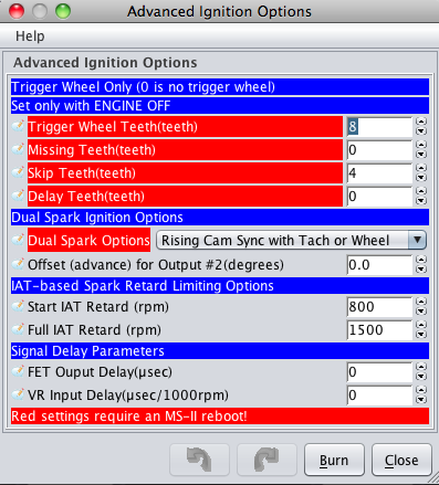

bigbrotherjohn, I meant to respond sooner with this screenshot, but laptop elsewhere.Paul_H is right with his statement Rising Cam Sync with Tach or Wheel. You need to have two tach events per crank rotation, so skipping 4 teeth will do that.
This is a screenshot from my Thunderace settings...
Thunderace "8 tooth" trigger
Screen shot 2009-12-22 at 16.42.15.png (53.19 KiB) Viewed 1332 times
