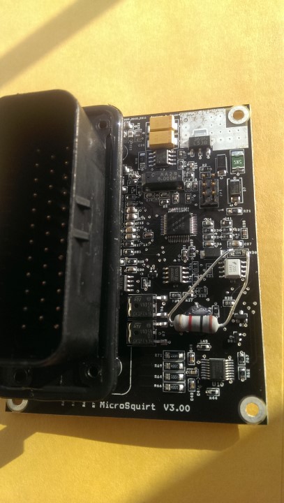

Problem solved. Thought I would post the solution so many post always end with unfinished problems and it makes it difficult to find answers. After talking with tech at DIYautotune the resistor at R20 on the circuit board had shorted out and the fix is to solder a 1/2 watt resistor (case closed) literally.
