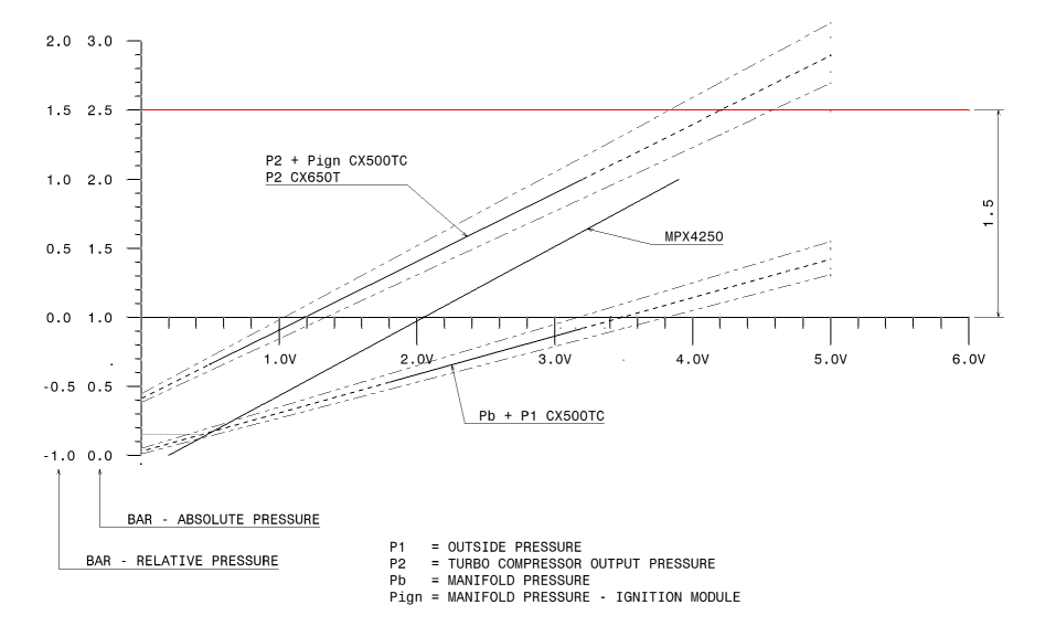

It is also established that I will be using two of the three MAP sensors for input to the 'squirt: its P1 sensor which sources its signal just after the air filter and thus will be suitable for barometric sensing; the P2 sensor which has the range at 5v to sense boost to over 2.5 bar above barometric.
A visual representation of each sensor's range is shown below and as you can see, no single sensor is conducive to all-around operation.
The P1 sensor is connected to the intake after the air filter, as mentioned. P2 is connected to the "surge tank" between the turbo and the throttle, and Pb is connected between the throttle and cylinders. As the P2 sensor lacks resolution below -0.5bar, I'm contemplating connecting P2 to Pb's port and then using alpha-N (at low rpm) then transitioning to speed/density at higher rpm's, with the transition to speed/density occuring at approximately 4000 rpms, which is where the turbo is making significant boost (>5psi). I've not ruled out using a 3-4BAR sensor to replace Pb (or P2 even) should it be more beneficial.
My question is with regards to the best way to do this, sensor selection, tuning and all.

I would strongly suggest using a single 3 bar map sensor rather than trying to utilize multiple sensors as standard.
