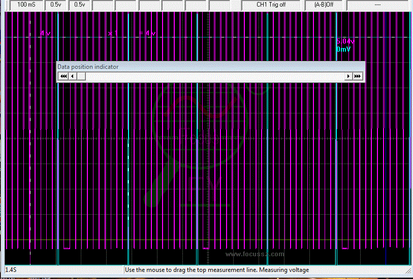

Inj 1 w/cam signal:

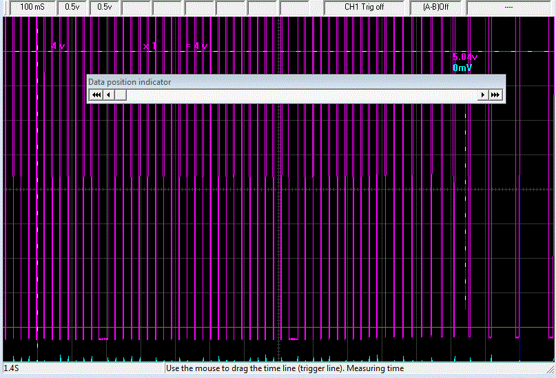

inj 2 w/cam signal:

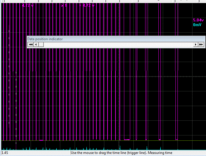

ignout1 w/cam signal:

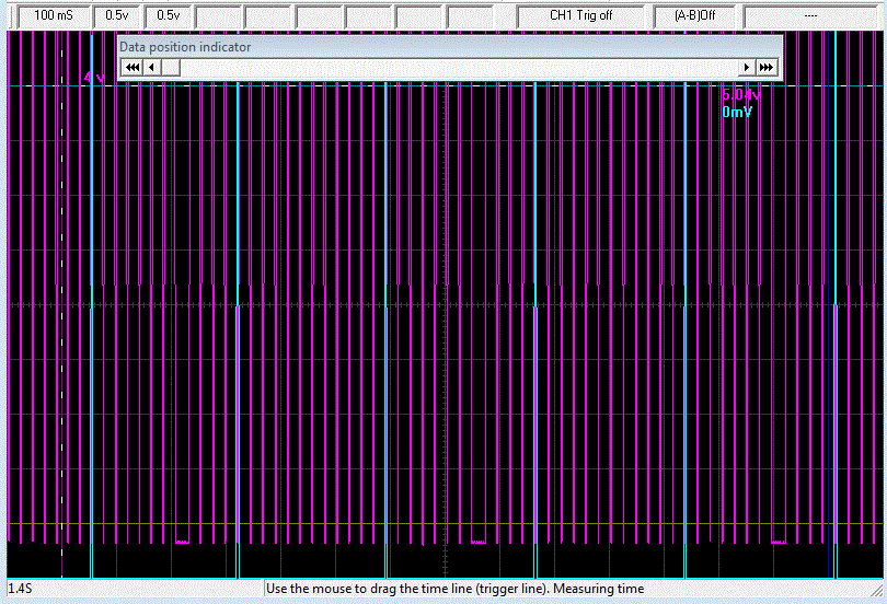

Ignout2 w/ cam signal:
I have an idea what I am seeing here. but that is all. I just watched a youtube video on how to use my digi-o-scope (first time)
I see 5 inj pulses on inj1 and 2, and they are happening at the same cam phase from what I can see. It looks like ignition is correct. Maybe I am having an injection timing problem then.
//edit: this is during cranking. ~200 rpm. the injectors were disconnected, that's why they are just blips.

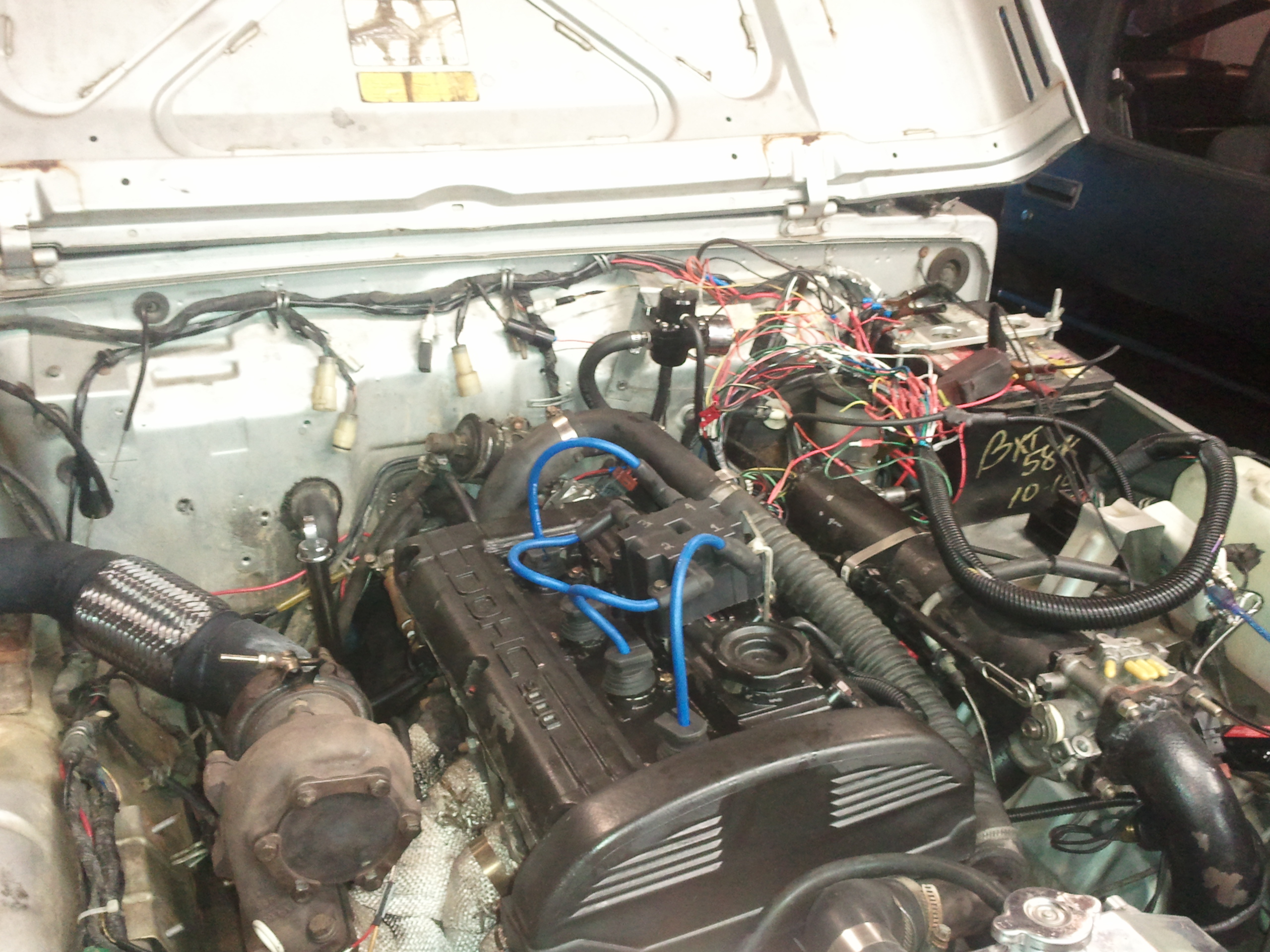

Here is a picture of my setup as of now:
